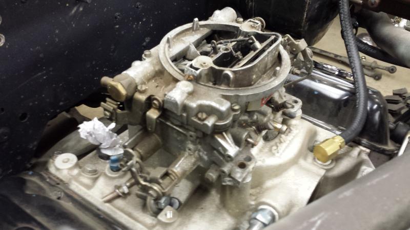

Gotta get a rebuild kit tomorrow for this..

Don't go too far on that carb. I may go with a truck avenger carb if that needs any work.
That carb has never been run.
Its been ran from looking at it.
I would not go with an avenger carb--most are pretty high CFM and you will not be happy with the over fueling..

No sense in waiting time/money on that other carb..
Not yet, but I can. It's a spendy little bugger!
That old carb really has never been run. It was new for that motor.
I can get it ordered up.
So is this a good place to discuss TBI vs carb, since it seems that the existing carb needs work?
On my 4Runner, I jumped out of the carb as quickly as I could after driving it. I LOVE my MPFI system on the 4 Runner.
Is a TBI system worth the extra money?
Ideas? I don't see saving $900 in fuel very likely so fuel efficiency isn't huge. Reliability is important...
