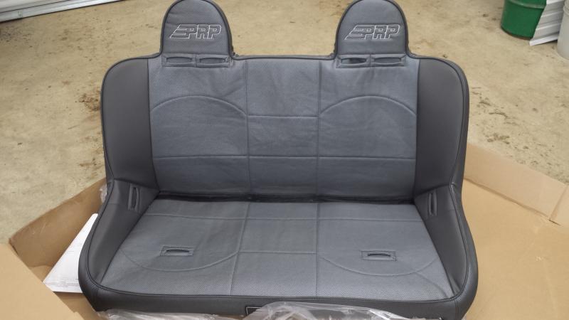

Nice lookin seat..

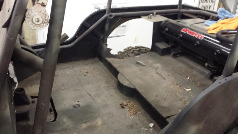

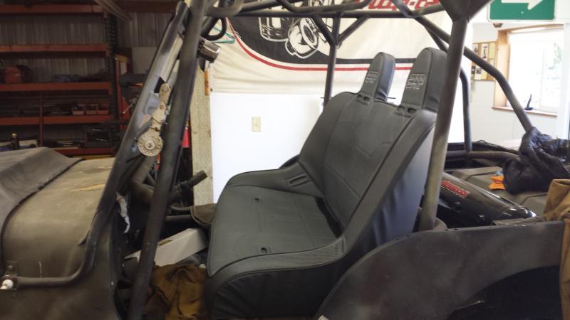

So dale I need a measurement from ya.
Need ya to sit on the floor with your back straight and I need the measurement from the floor to the top of your head...
39"
Jackson may be a little taller than me.. when he's finished becoming a giant.
So the reason for the measurement is my fear is with that seat and how the seat bars are--too tall. I am going to get it all measured up in the am and see if I can even make it work with thats there or remove all the seat stuff, roll it back like you want and build all new..
The only way I see us fitting is if he seat goes back as far as it can.
Only smoke is from the ol brain trying to get some measurements with the seat--end conclusion I gotta cut all the seat tubing out and quite possibly the back of the floor. Won't know that until the tubing is out. Gotta get some more too since I am plum out.

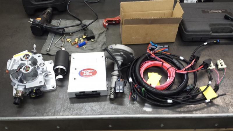

Did get the parts to get the clutch slave mount built so been toying with that too.

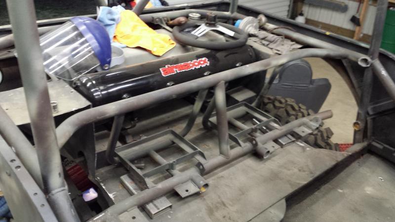

Removed the seat mounts.... I outa tube and hoping to get a load by tge end of the week...
So I did a rough cut and removed what I knew wasn't going to work and threw it back in and kinda set it where I wanted to see if I can even reuse it..
I came to the conclusion I should be able to make it work.

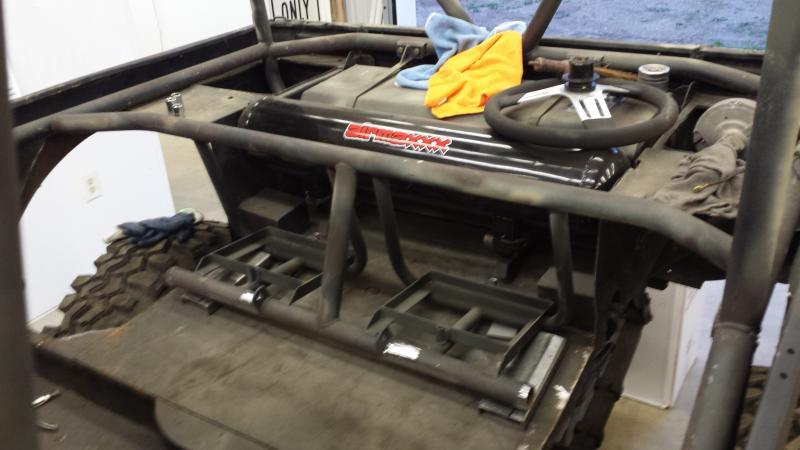

Took some time but removed what tube I needed to and again roughed it in.
