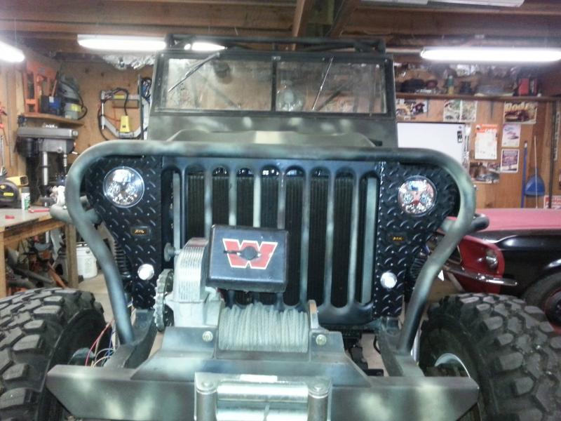

A few updated courtesy of Rew T customs.
The finished grill with diamond plate and all LED lights.

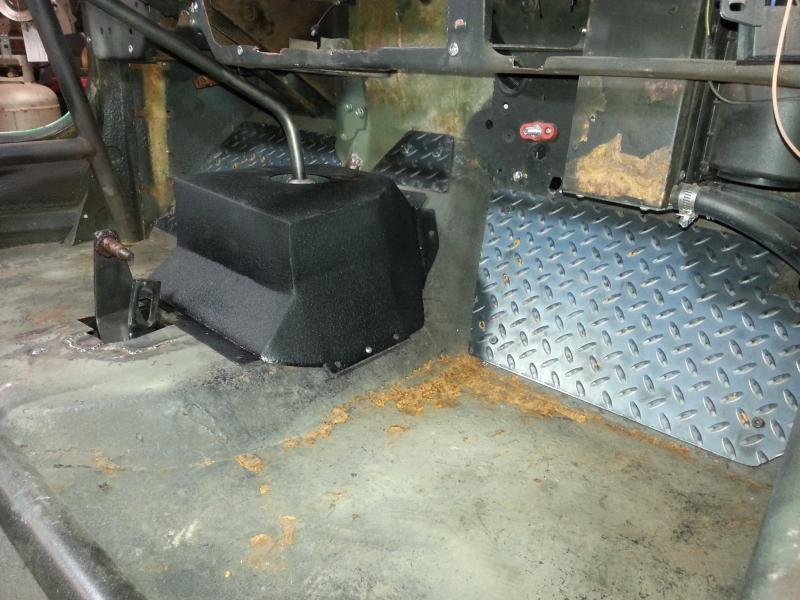

The new transmission cover and floor plates to cover over all the holes.

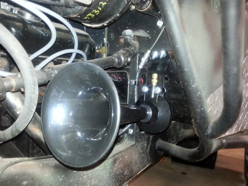

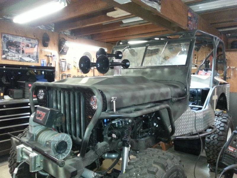

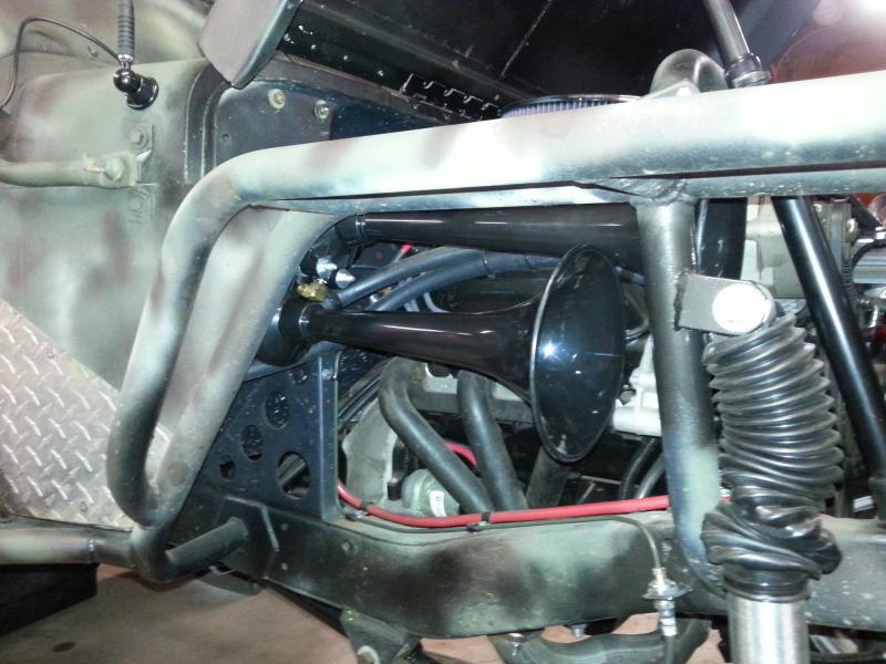

Those horns are going to be so full of crap in about 20 minutes of driving... :redneck:
They are going to need some sort of sock cover on them, like you'd use on a K&N Filter.
They probably need to be angle down a little bit too, so that they drain out if water does get in.
This is where James wanted to mount them :)

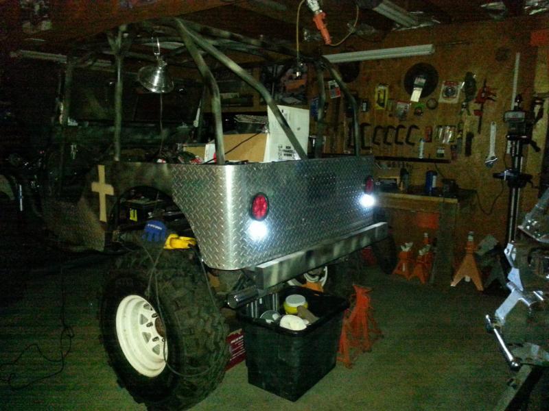

The LED backup lights are installed.
The floor panels are getting finished. When they are all done, he's going to powder coat all of it.

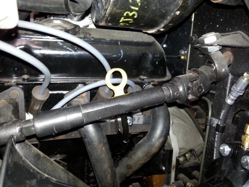

The dipstick was hard to find and still required a little tweaking for it to work with the headers.

The t-case shifter was cut down so that it would fit between the transmission cover and the seat without interfering with anything.

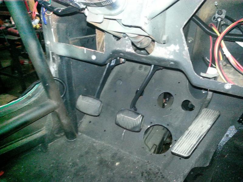

The pedals were cut and re-cut until they finally sit in a position where you can actually drive.

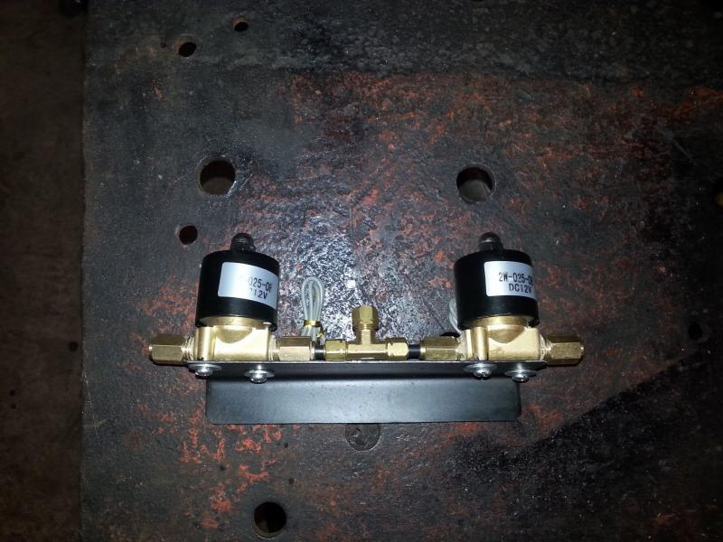

The air solenoids are installed and mounted. When finished, there will be a horn button that will function with the removable steering wheel which will use the smallest air horn. When the lanyard is pulled, all three horns will blast. This will give the emergency honk of a loud, but legal horn and the fun blast of a locomotive horn when you want to scare the pants off someone.

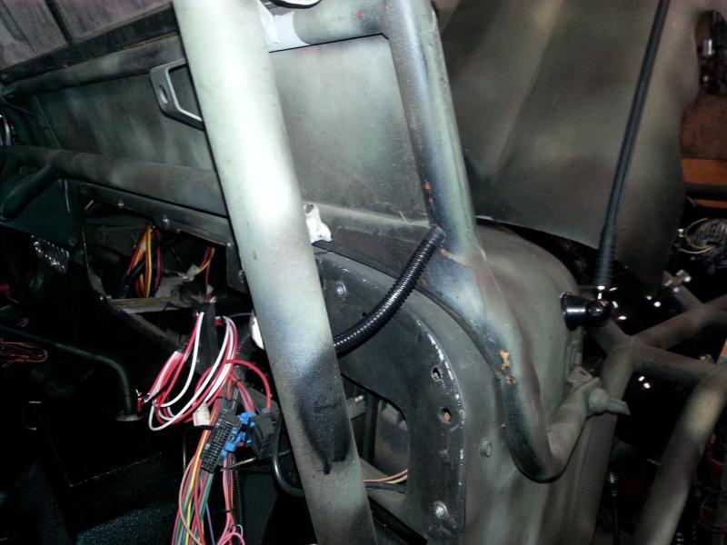

The wiring for the wiper motors is run through the frame and will still allow the windshield to fold down.

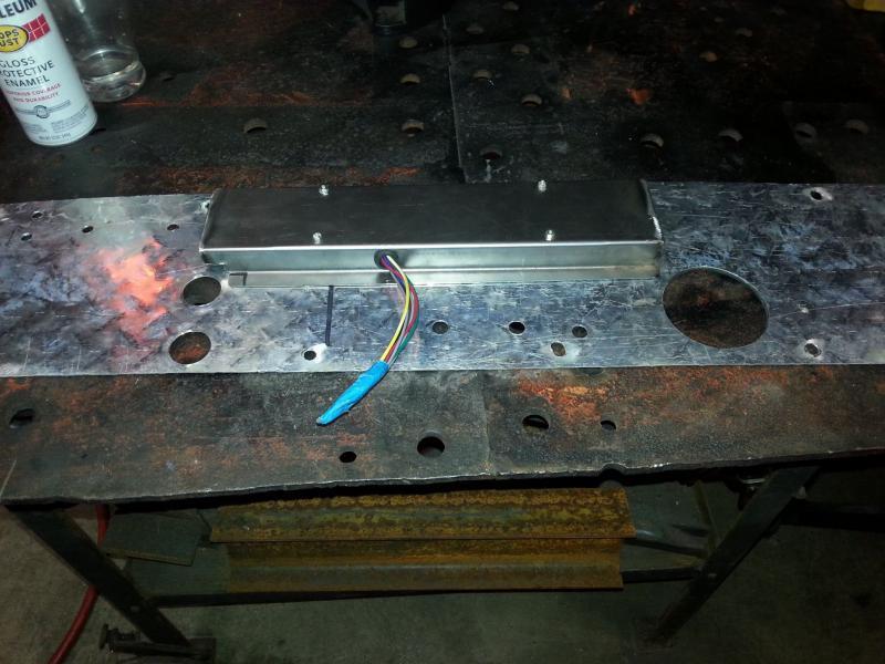

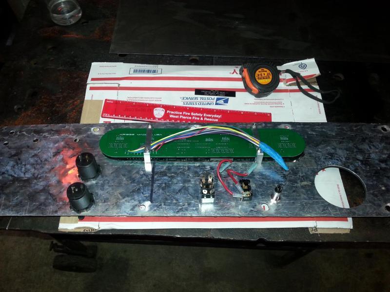

The LED digital gauges are installed. James made a water tight box to protect the electronics.

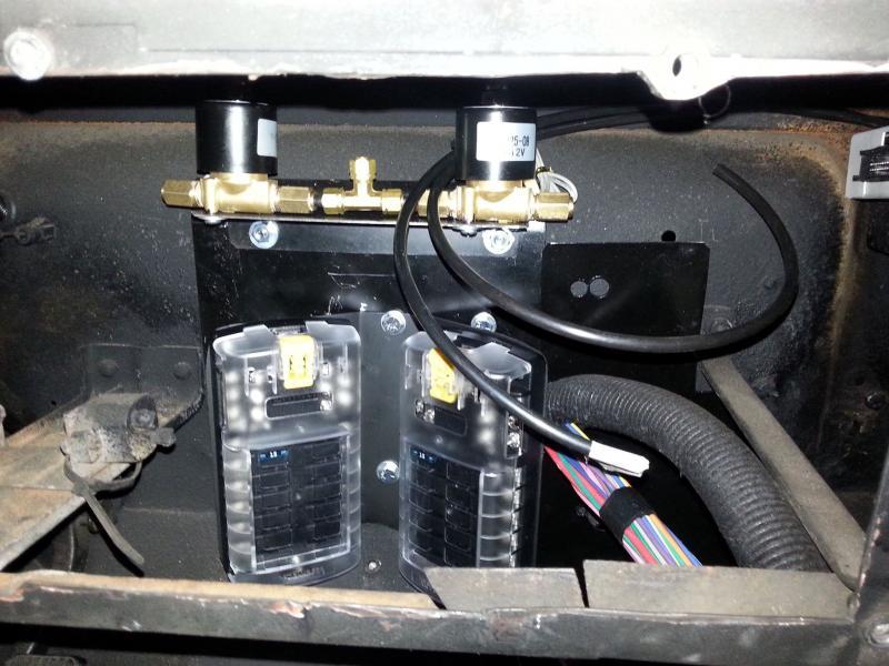

The solenoids and fuse blocks installed

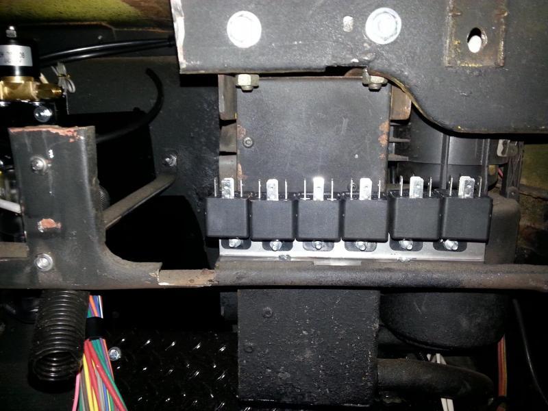

The relay bank is mounted.

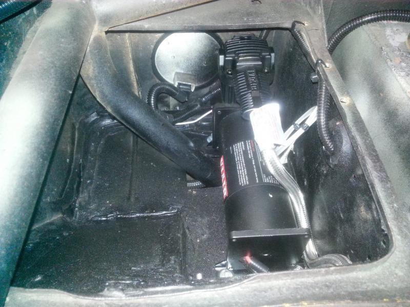

The air compressors are installed in the old tool storage areas. These were completely rusted away so James to build new ones.

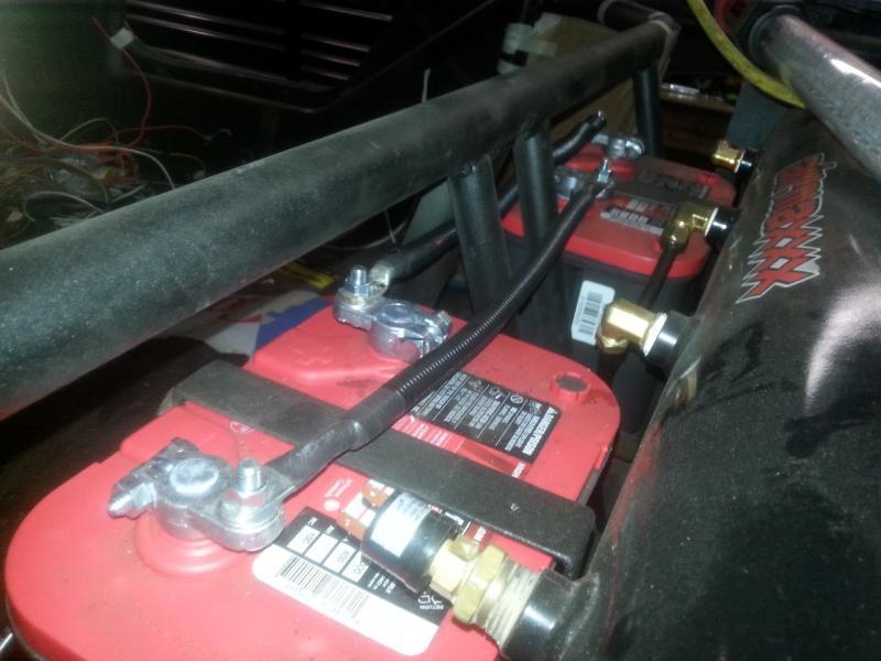

The batteries installed and connected right in front of the air tank and right behind the bench seat.

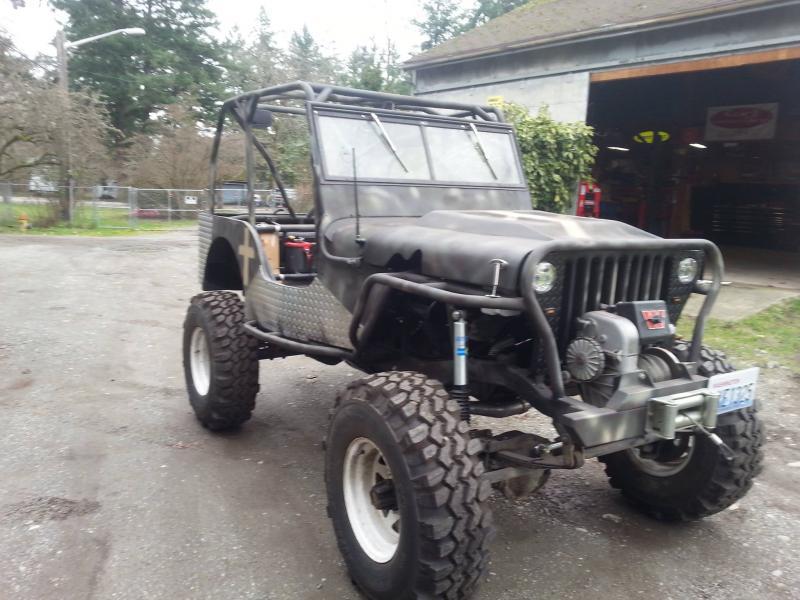

It's getting SO close that I can smell it!
James has the Crash syndrome...
The work he is doing is FANTASTIC, it's just taking SOOOOOO long. I'm sure he feels the same way.
It's close enough that it's now licensed and insuranced, just waiting to drive it back and do a little finish work on things like flares, mudflaps, side view mirrors, etc.
Getting so close. It's now licensed and insured.

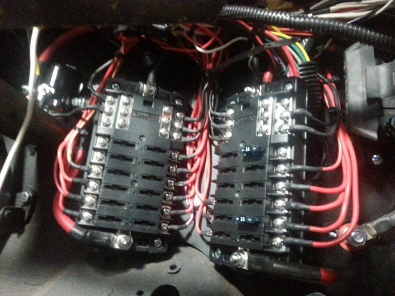

The fuse box is wired, still needs fuses added and all the final testing.

The wiring is finally 95% done. You can see from the pics that this isn't a hack job.

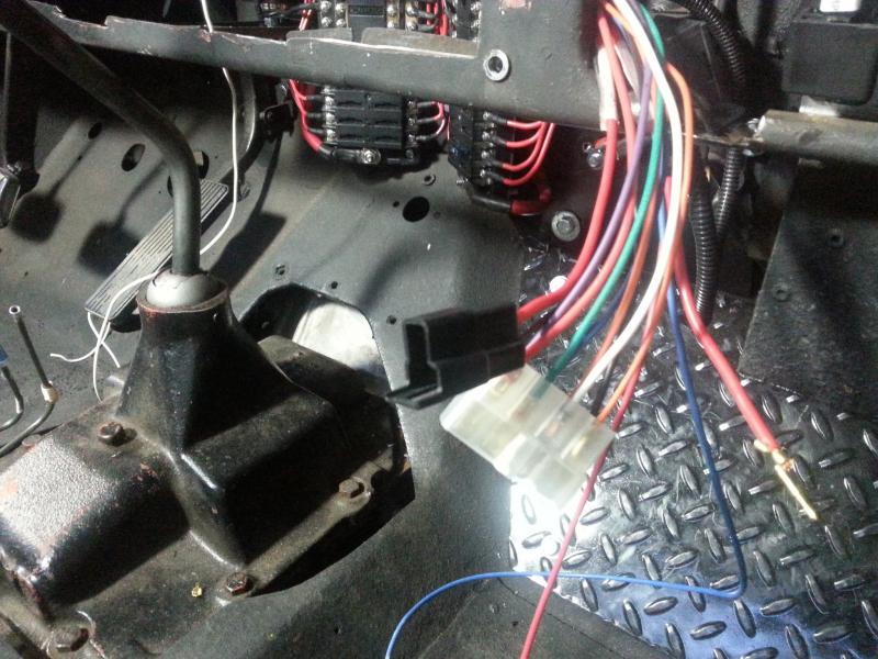

1) Final install of the dash and the switch panel. James wired everything with plugs so that it will be relatively simple to remove the dash with only a few screws and a couple of plugs.
If those relays are mounted upside down, you are going to want to either
A) remount them right side up,
or B) drill small relief holes in the bottom (top) of the relay for moisture to escape.
I have seen these fail, even in a 'dry' environment, due to moisture collecting in them over time when mounted upside down, there is no way for moisture to escape, or vent if you will...

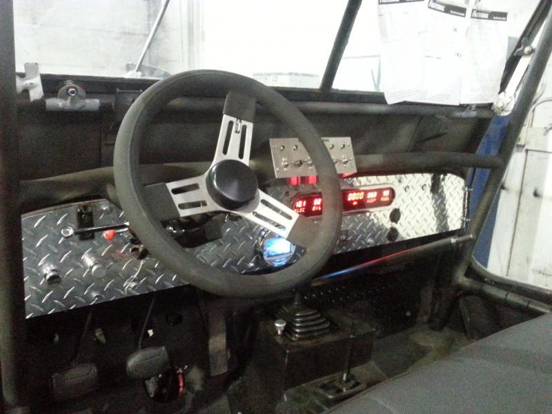

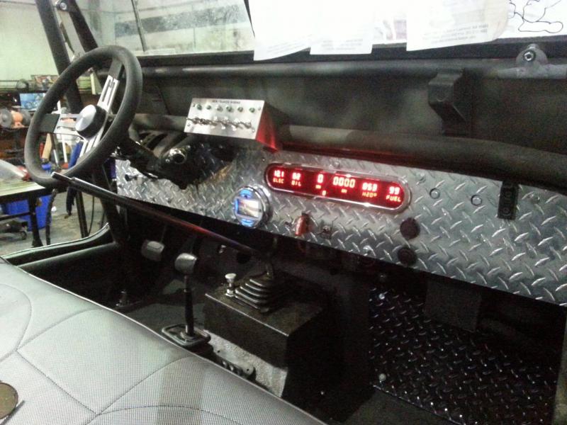

A couple pics of the dash installed.
That is a working horn button on the removable steering wheel.
Blinkers are working as are the wiper controls. High Beam control is on the floor.
Notice, No ignition switch :awesomework:
Bottom right of the steering wheel is marine radio.
Fully digital instrumentation cluster which includes a GPS based speedometer.
It has an "armed" controller for the winch.
On the panel box on the tube, are all the accessory controls for the electric fan, air compressors, front and rear LED lights,
The round plugs are a 12v power outlet and a USB power outlet.
There's even a check engine light on the dash.
The transmission tunnel is done with line lock installed and the shift boots in place.
