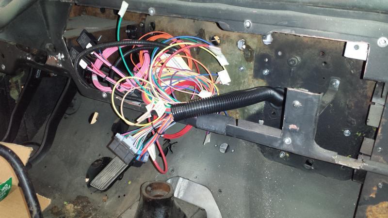

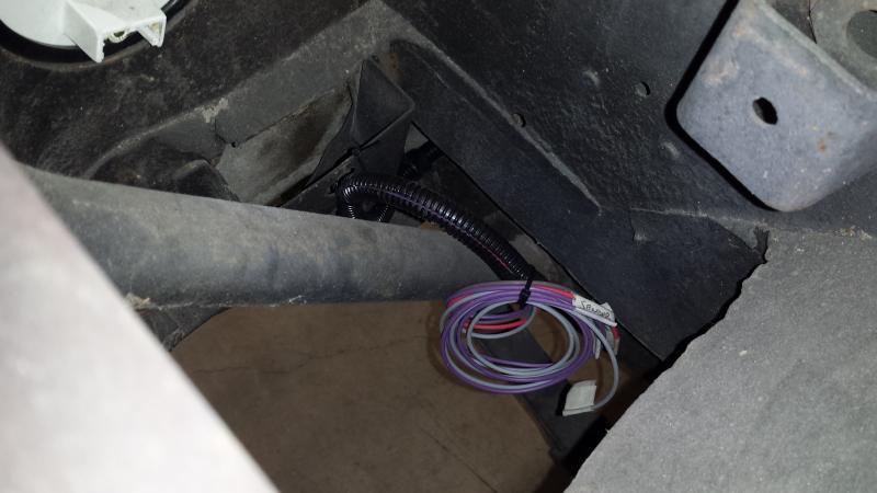

And the wiring is pre-ran to under the dash.
This is where james will have to take over since I have no clue whats instore in the dash but everything is marked with plenty of wire...
With the length I left for the Ecm there should be some good options for its mounting. There is a sweet spot for it on top of the heater box but I don't suggest it going there due to the heat factor.. It needs a spot that will get some air and water resistant....

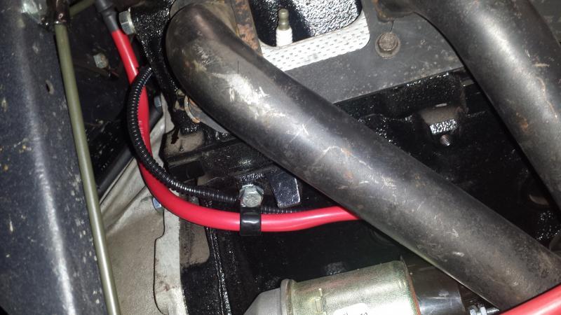

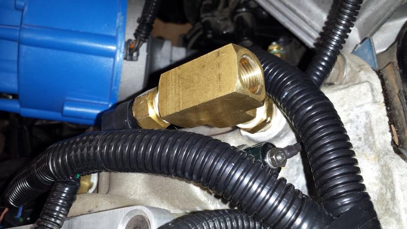

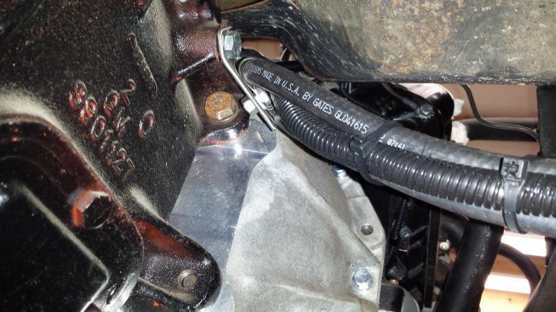

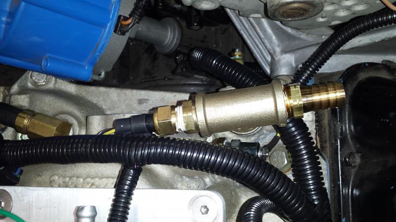

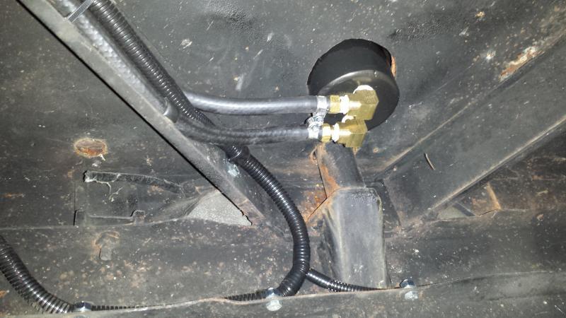

Made a change this morning and swapped the 3/8 stuff for some 1/2. The 3/8 was a little restrictive.

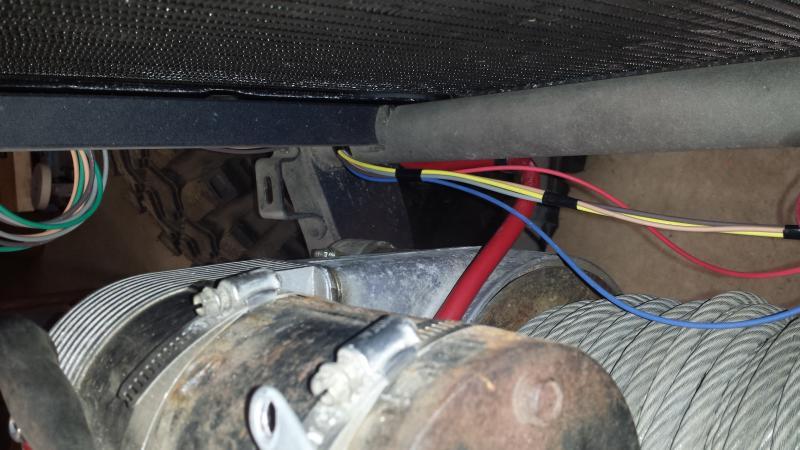

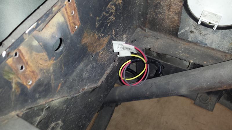

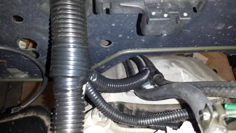

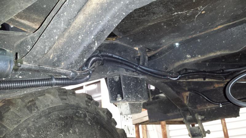

Ran the front/rear wiring thru the same pass thru harness..

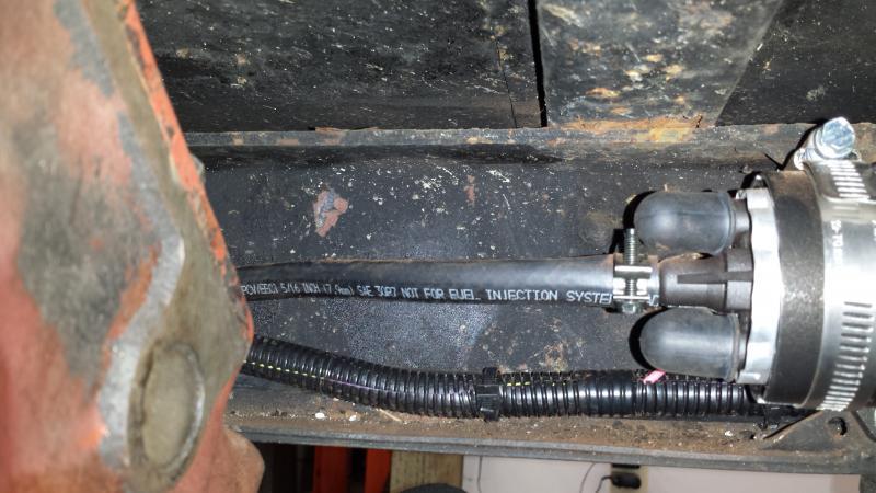

The front/rear harness is done. I pre-wired Park lamps/brake lamps/LH&RH turn lamps. I also pre-wired for a fuel sender in case dale wants to add one to the tank down the road and also a turn on wire for the air pump.

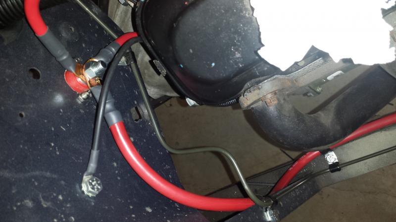

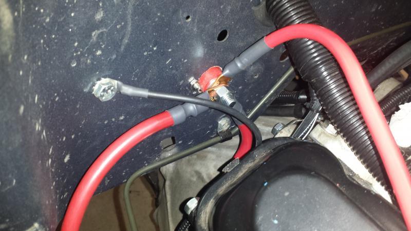

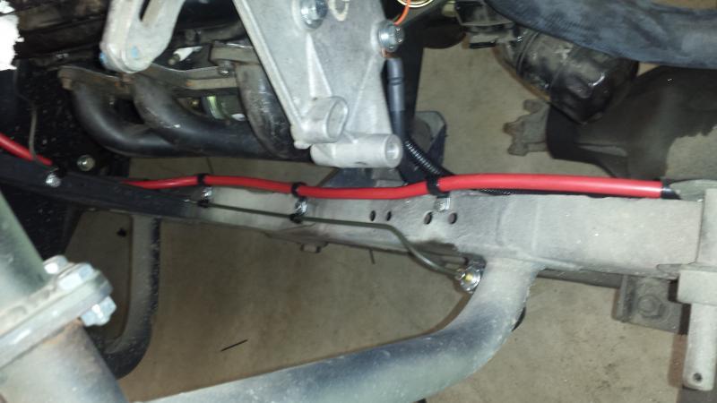

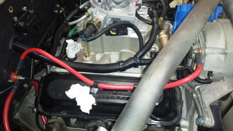

Got the main junction pass thru installed and all the main power feeds from there forward done (alt, starter and winch). That finishes the wiring I will be doing.

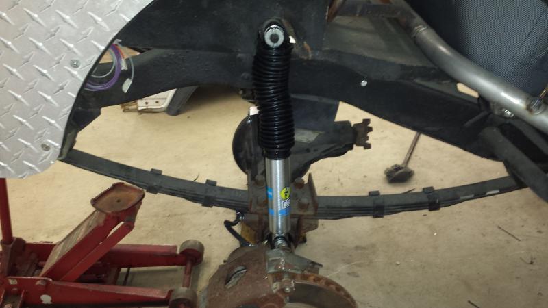

whats the status of the shocks dale?

Shocks and hoses should be on your doorstep on Thursday.
