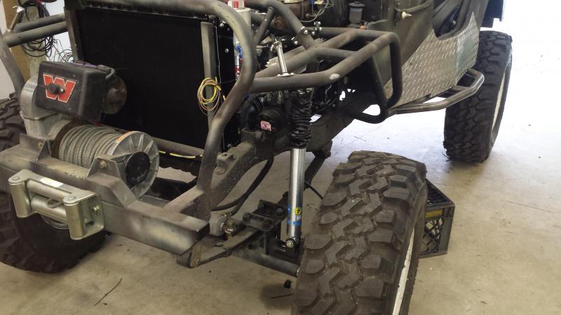

Little Gibby's 45 MB
Front shocks done...

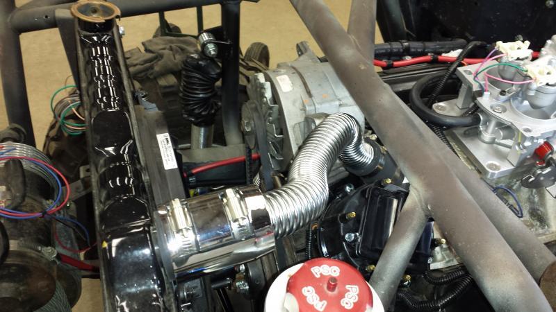

Now to get this roughed in. It will have to be tweeked after i am done with it once the dash is done. Sure glad i got my tanks filled recently.

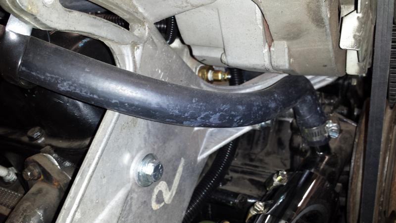

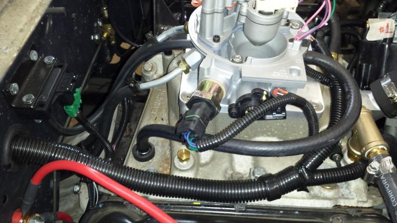

The water neck and distributor hold down parts arrived today. Sending those to you on Monday.

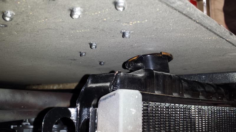

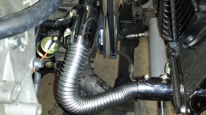

Thermostat housing installed with 180 thermostat. Upper rad hose bent and installed. Once the rigs running and the timing is set the dist cap will need to be ground down to clear the rubber insert so you can roll the hose clamp down farther. when ya see it that will make sense. Since these hose setups with the small insert the rubber is about 3/8" thick..

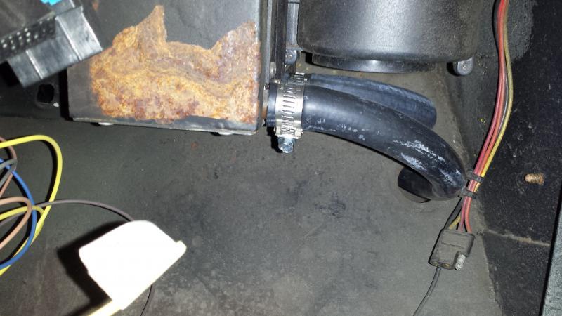

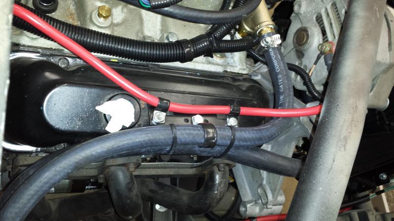

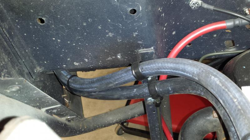

Heater hoses done. The set you sent was too short and they would not have worked with the sharp bends. I had to get a pre-bent molded hose for where it hooks to the water pump/pretty tight..

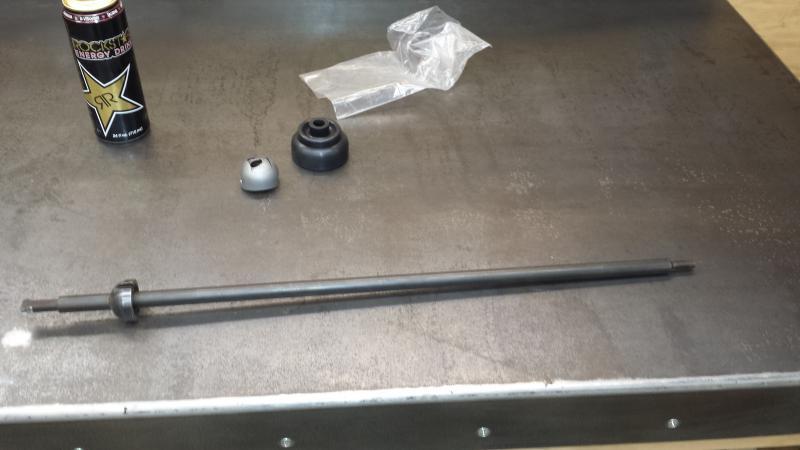

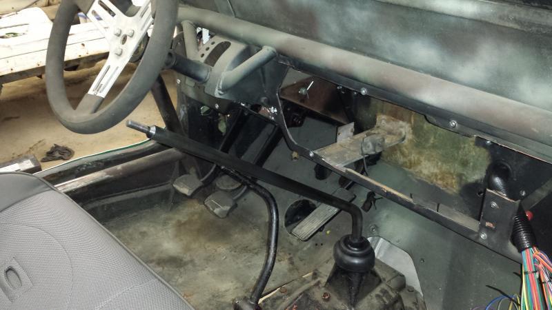

Took the seat out today, Jackson wanted to get the paint can out. Of course, we were all out...
Exhaust is going on tomorrow then getting some bids on drivelines. I haven't found a driveline brake for this setup yet, still searching. I may just have to go with a manual rear line lock
Best option you can do right there is the line lock. I've seen and have had the driveline brake fail from bolts backing out or simply doesn't lock tight on the brake. Go line lock, not worry about your driveline falling out and pencil diving. I learned
