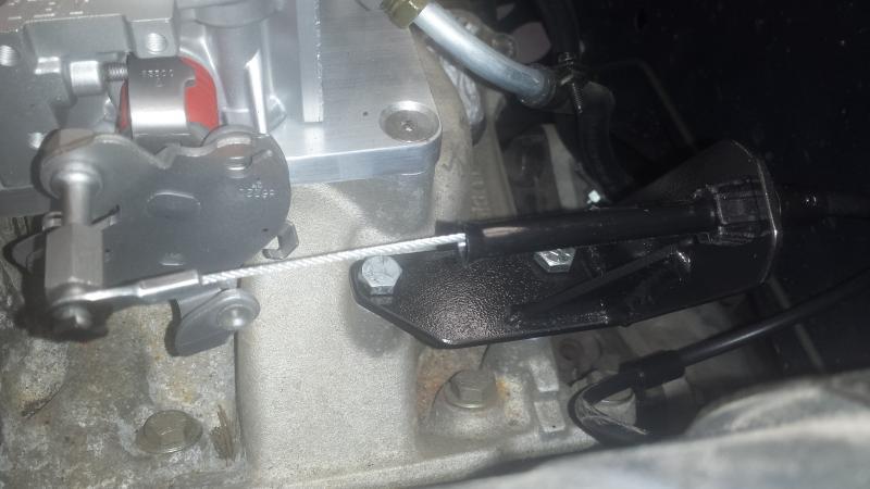

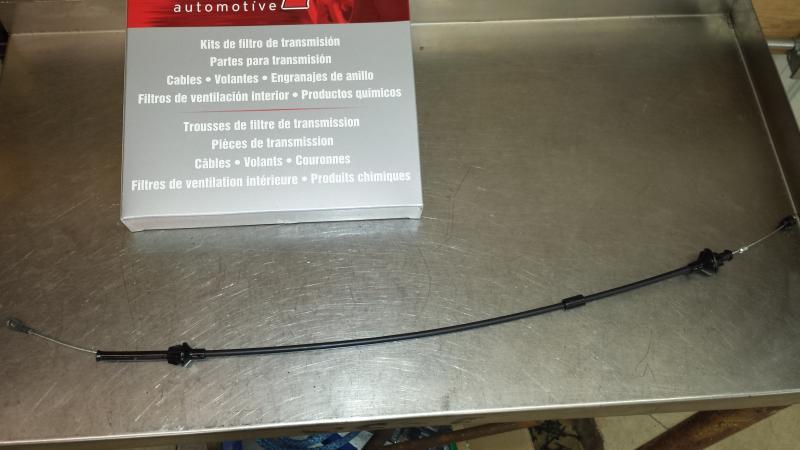

Grabbed a tbi throttle cable so time to build a bracket since i can't find anything prefabbed worth a damn.

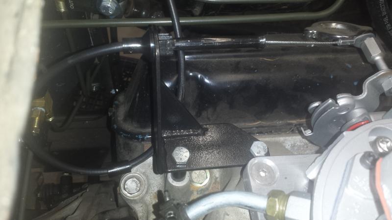

Accell cable bracket at the tbi done..

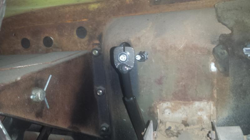

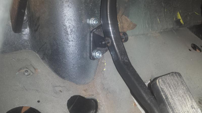

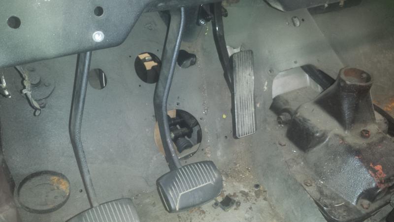

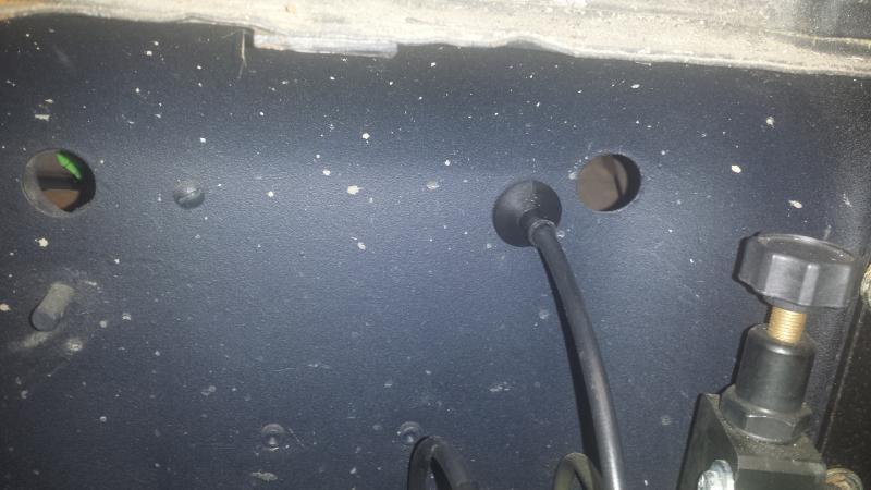

So I got pissed and took another look at the pedal that was in the pile. Well I was able to make it work with some effort. Due to the firewall/tunnel metting joint and where the pedal needed to mount I had to first make a 1/4" spacer.
Next part wasn't too bad getting the top of the pedal rebuilt to fit the cable/travel. It actually turned out pretty good...

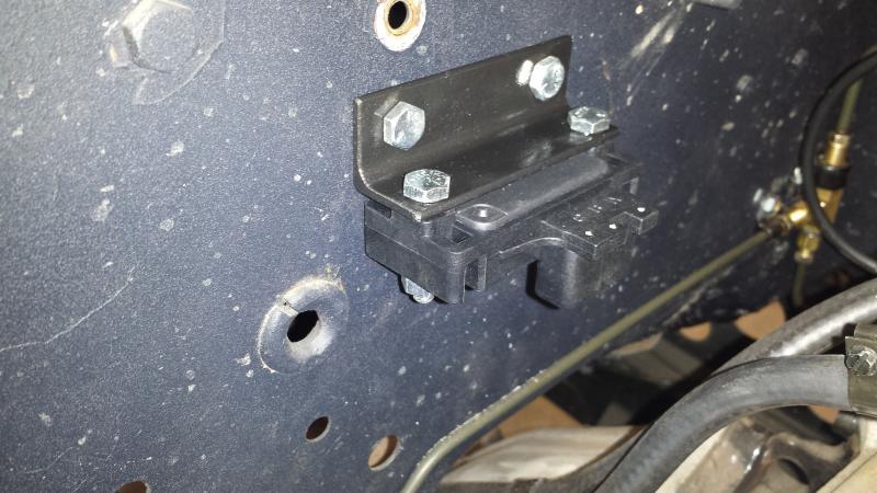

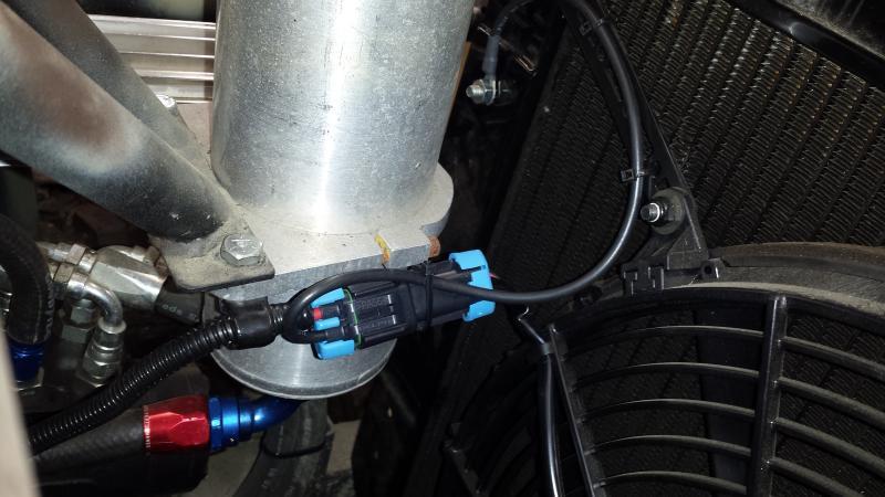

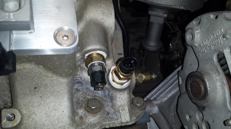

Some odds and ends. Got all the sensors installed. Had to make a bracket for the map sensor.

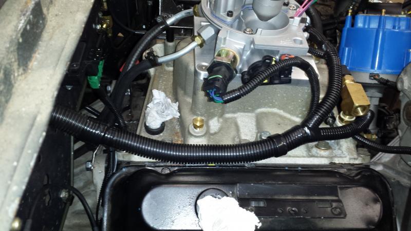

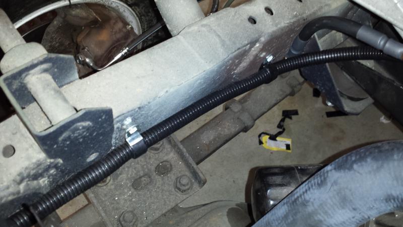

Look at how crappy these pre-fab harness's are made for fitment. My big pet peeve is when there are multiple harness's under the hood--drives me batty..
So I have "always" routed them properly and incorporated the rest of the wiring into the engine harness. You have less feet of wiring and when routed properly the chances of failure are reduced greatly.
Step one---routing--its all about the routing IMO....

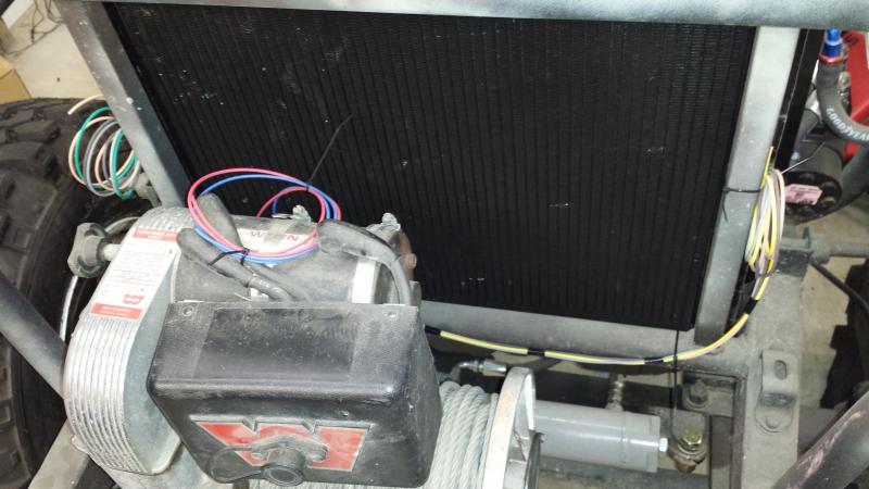

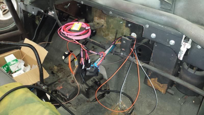

Front is prewired for winch control, headlights (high/low beam) park lamps and both rh and lh turn. Its pretty close but without a nose I can only guesstimate...

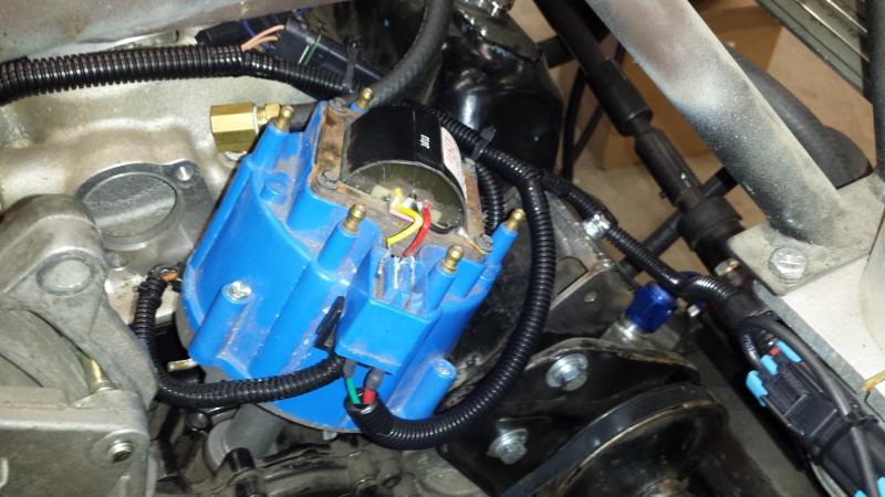

So the engine wiring is all done except the main power leads (winch/alt/starter).
