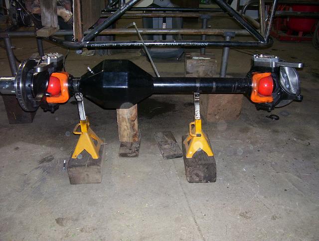

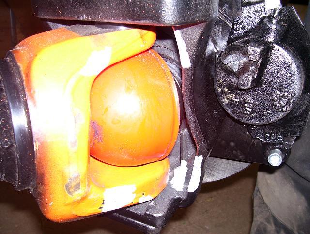

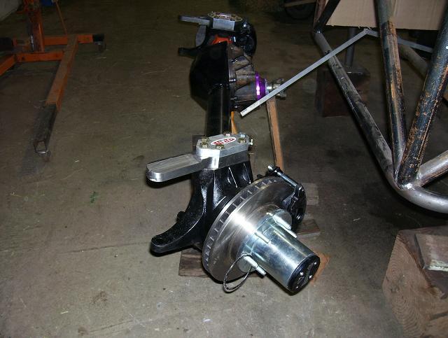

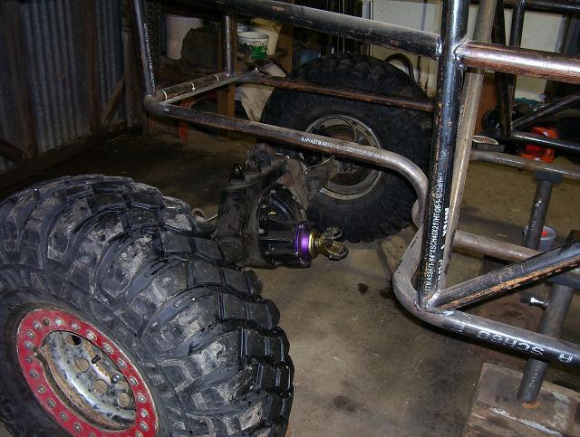

mod. class, 30' "A" build up
30 degrees of turning like my old toy set up in the first pic and 45 degrees in the second pic

had to a bit of grinding to get the full turning allowed by Bobbies axles

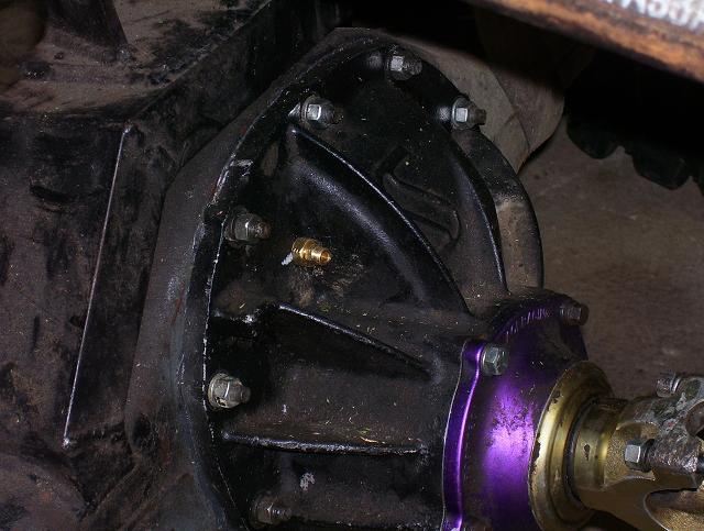

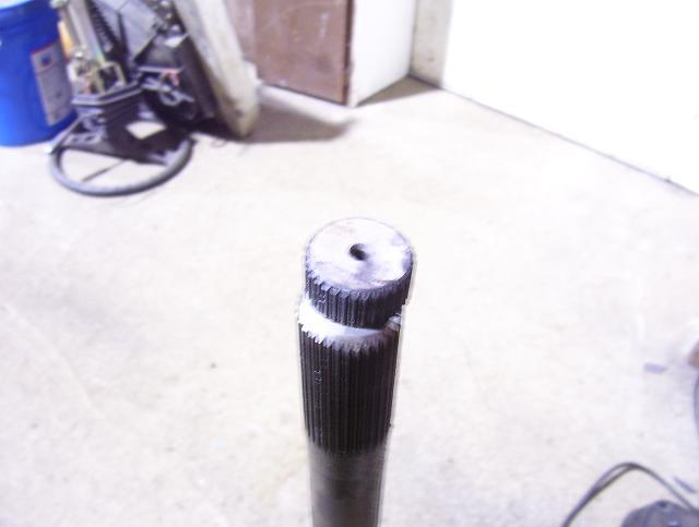

after installing the the third member in the rear axle with the ARB, I discovered a slight problem with the 35 spline stange axles that I had been running. I was running a spool with no cross pin, well arb's have them so I had to shorten both axles to make them fit.

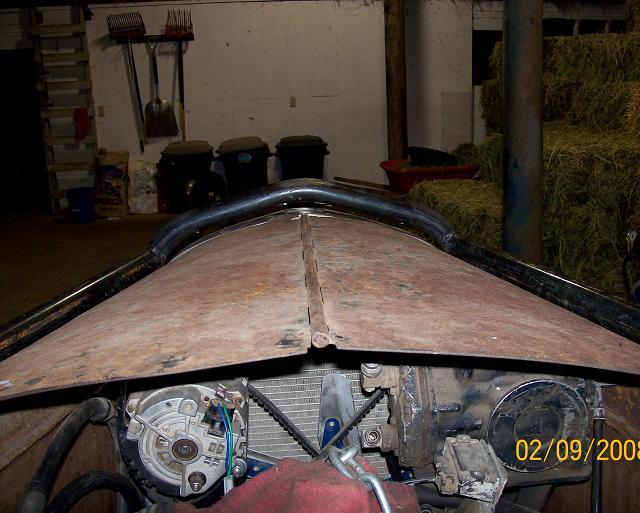

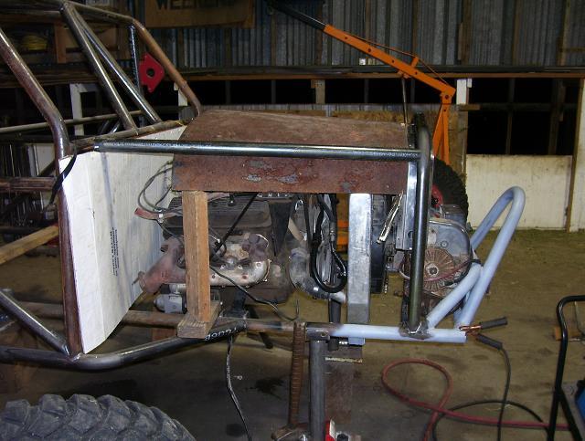

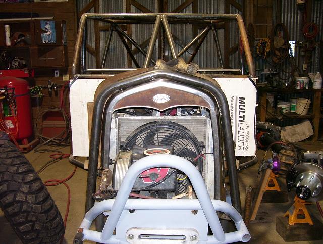

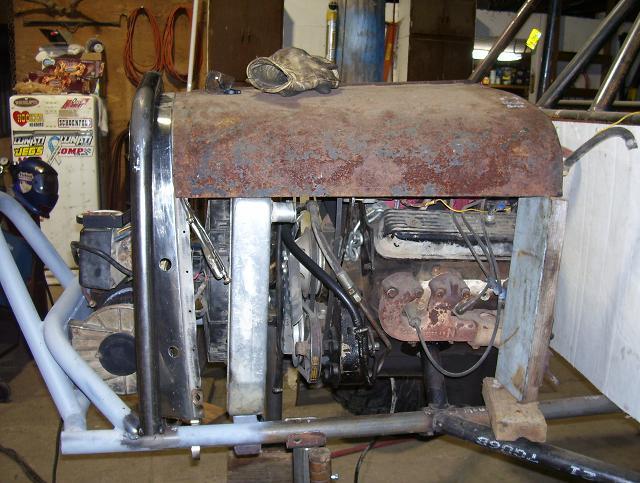

bent a hoop around the radiator shroud, kept it as close as I could get it so as not to destroy the lines of the shroud. I figure that the sheet metal is close to 80 years old that I should try to save it with an exo front end :;

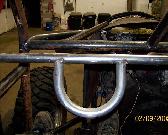

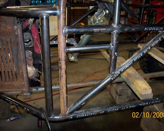

the side bars running along the panals
going to run another tube from the side panal bar the the outer edge of the A pillor to help shiat slide past the A pillor

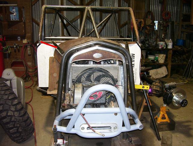

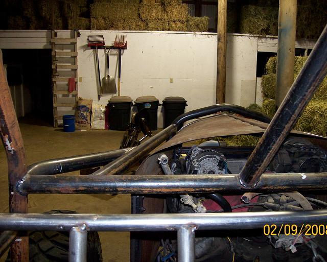

What did that clip do to your visibility? One of the reasons I built my own was to be able to scale it for both apearance and visibility/function.Don't get me wrong,i think what you have is sick and bold(vintage tin) but I personally couldn't sacrifice visibility.I'd like to see both our cars side by side....that would be cool
Very cool build!! Gotta like the vintage tin- not something you see everyday on a wheeler!
if you look on post # 57 I give a shot of what it looks like from the drivers seat, I will get another one here in a lil bit. I was going to build my own but the cost to buy the stock stuff was to cheap. I do not think that I could get it much narrower. Everything is super tight under the hood as it is :; .
the view looking from the drivers seat, I am really happy with how the hood and hoops line up :redneck:

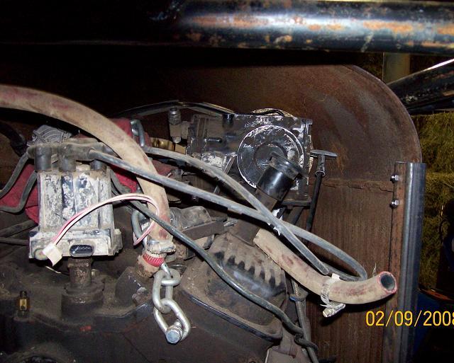

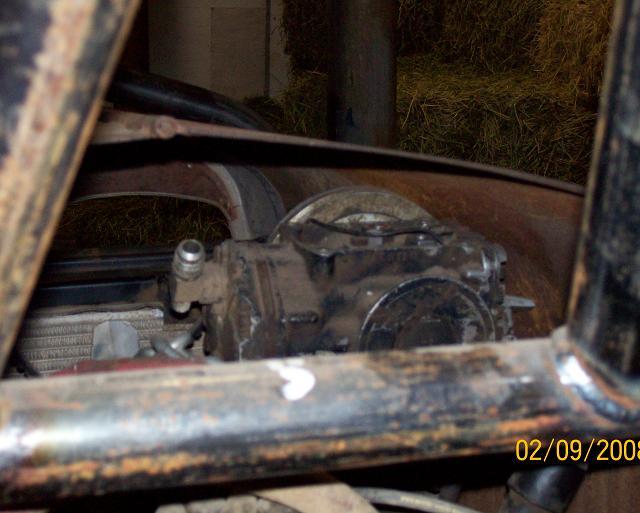

its a tight fit under there:redneck: , I am going to have to lower the AC compresor because its hitting the hood.

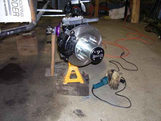

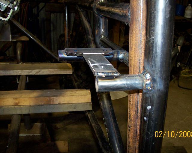

had to make a few more inches of leg room so I added a new tube in front of the A pillor and also behind the hood, I mounted the brake bracket with some 1" .083 wall. kinda waiting on some parts to show also, ordered up some more brakets from ruffstuff and ballistic fab. The tcase showed also get here this week so I can start building the mounts and lower rails.
