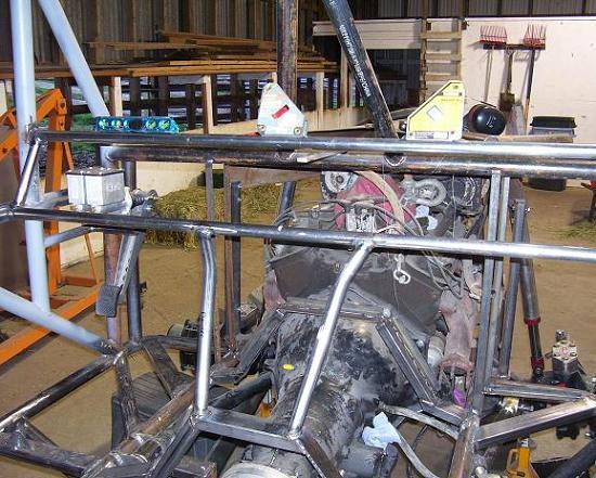

I skinned the underside of the axle to the closest hoop with 1/4"x6" and teh first to second hoop with 3/16". I also added a mounting point for hooking up to my winch.
a few pics of the front axle and skid plate on it

skid plate, runs from th rear of the tranny to the front of the oil pan, I still have to add the front brace coming down fom the motor mounts. I will also have a poly mount to absorb some of the shock from landing on rocks
