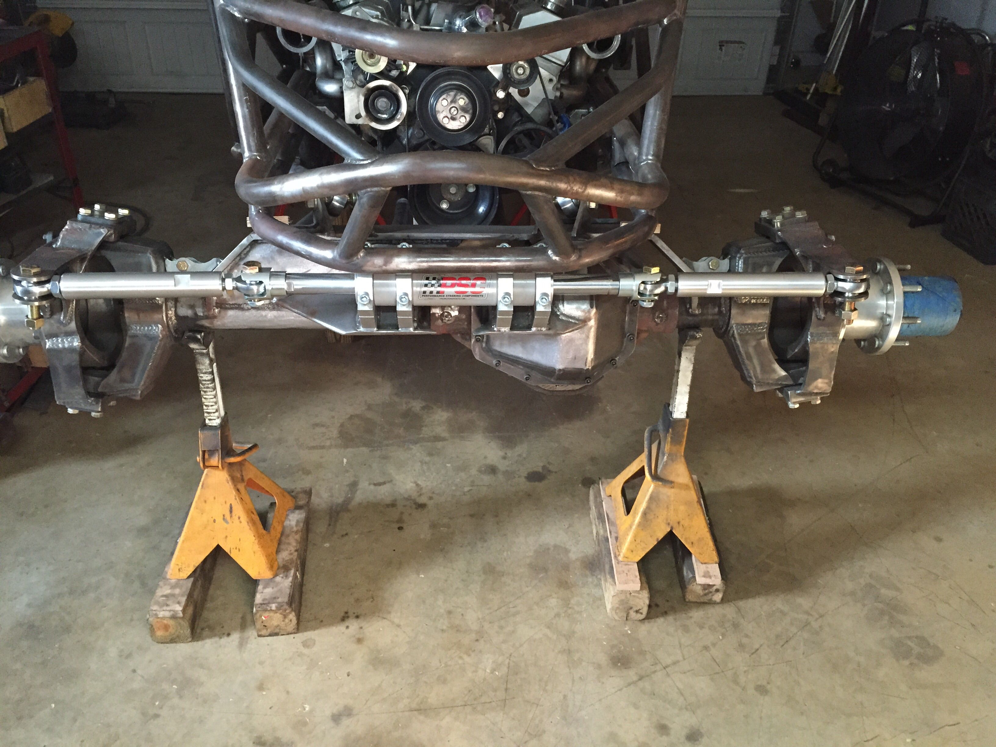

I went with ribbed housing, 40 splined spool, with 47 splined outers on WOD knuckles and spider trax big brakes, if I ever complete my build I'm certainly hoping the front axle will be my least worry

That's a good looking front axle, with those parts you shouldn't have anything to worry about, hell im still running 35 Spline Yukons and break one every now and then. That's the same axle im getting ready to build actually but with different knuckles and inner c
