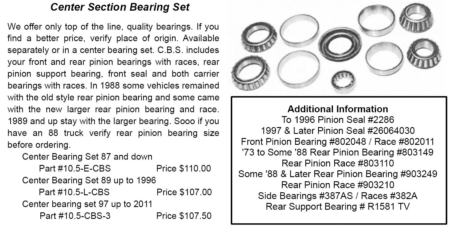

Can someone tell me the difference between the bearing set from '89 - '96 and '97 - 2011? From what I can tell it is just the pinion seal. I'm ordering parts for this build but I don't have the center yet so I don't want to get something I can't use. If it's just the pinion seal I'm not real concerned.
