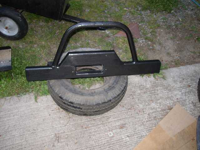

bumper:cheer:

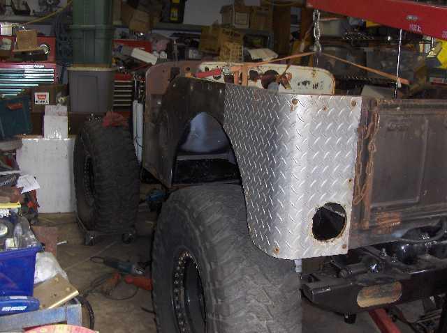

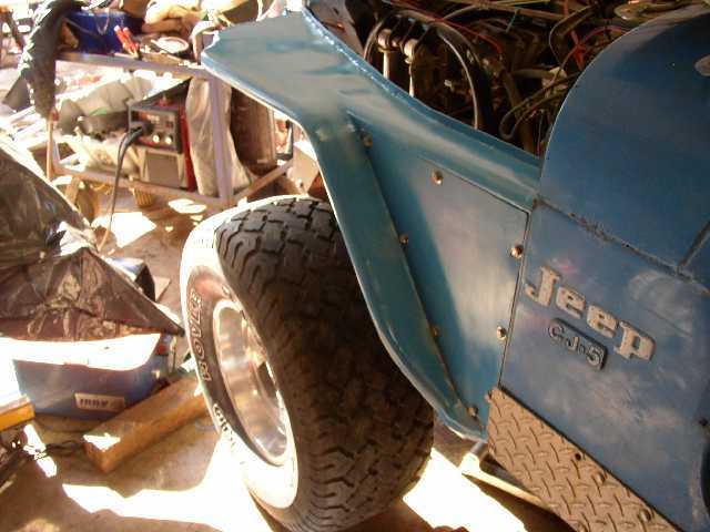

Looks good Jim!...........
I have set of 38x11 boggers that would sure look good on your rig. :redneck: :stirpot:
Good work jim. I see there was alot of work into those fenders. They look really good. :awesomework: Your rig looks ready for 35s. :hi:

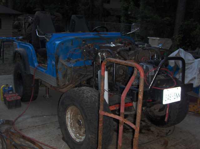

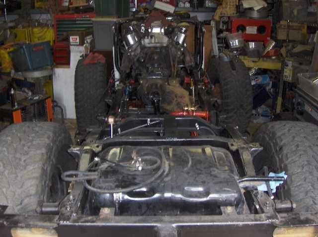

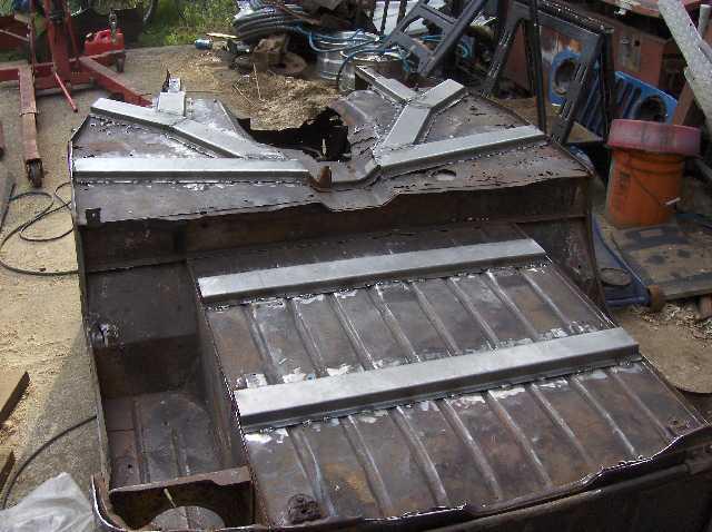

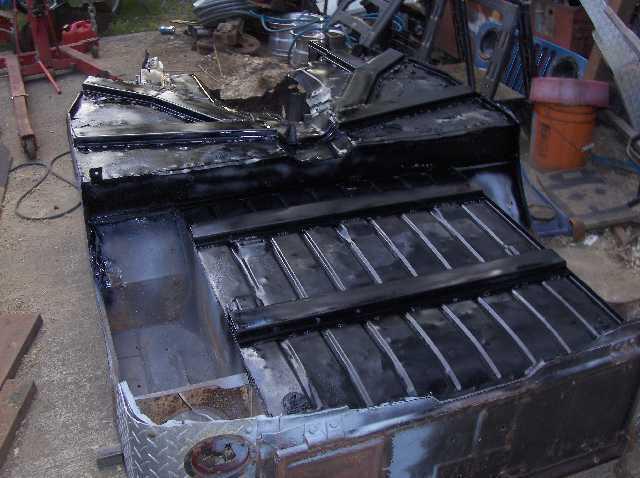

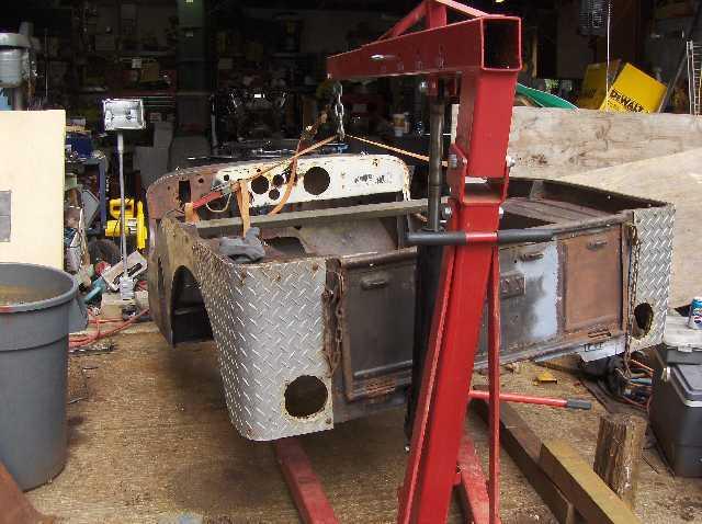

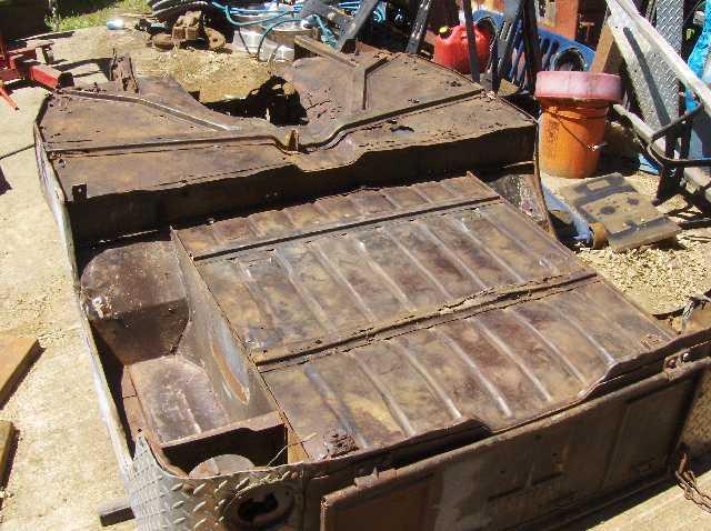

seems to be going backwards:booo:

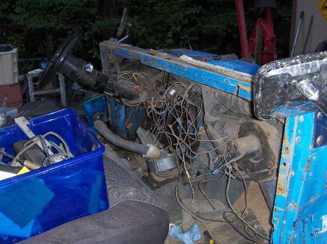

Kinda look like my cruiser. :booo: It's suffering from a slight case of no money no time.

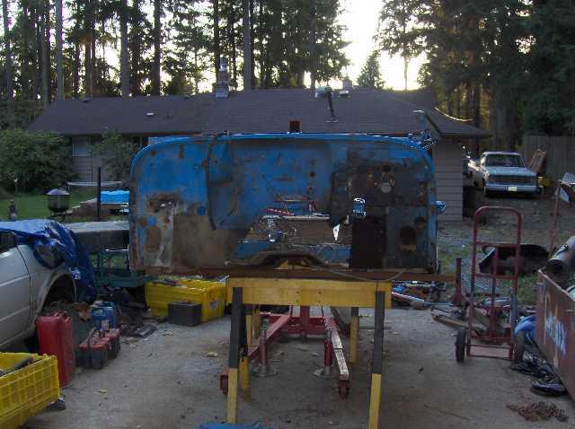

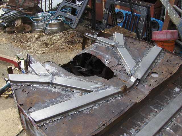

Naked jeep:booo: cant decide if its progress or regress:eeek: any which way its going to be a lot of work and money:booo:

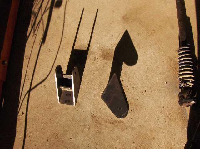

More progress / regress. The more I take off the more I see just how trashed the frame got. Its hard to see in the pics but the rear half of the frame is about 1" out of line with the front. also found several more cracks and the rear tranny mount was broken:booo: Picking up a new postal frame to start over with this weekend. Started gathering parts for the suspension. New heavy duty front hangers and the rear will be outboard and going soa.:cheer:

Jim,
Somewhere in the recesses of my brain I recall that postals are wider than late model CJ frames. Might want to measure widths before going too far in outboarding them springs. Also, with the narrow(er) track CJ axles, will you even have room to outboard?
Tony
Jim,
Tony
Several of the guys in our club use the postals under their flattys. I havent actualy measured the width but I will be doing a lot of measuring when the frames are side by side. The postal is also already outboarded in the rear. Also toying around with building a new rear end, (44 hp) so if needed I could make it a little wider.
Do you still have that 44 housing?
Sorry, that housing is loooonng gone. Regarding the outboarding of postals, remember that the postal D44s are wider than the housing you had (and if I recall correctly) wider than the 86 CJ D44 also. Plus, the CJ style D44 had equal length axles, but an offset pinion. The postal D44 had a centered pinion, but unequal length axles.
And DO NOT build a high pinion D44. In my lowly opinion, it is too weak for wheeling.
Tony
And for what it's worth, I could easily be wrong on that stuff because it's reaaallly old info from my brain.
