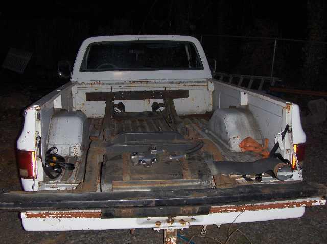

progress finaly:cheer: Got the new frame home and willl begin the stripping tomorrow:cheer:

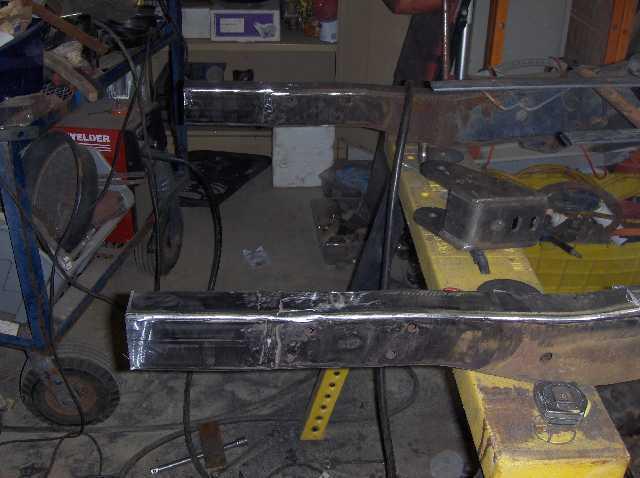

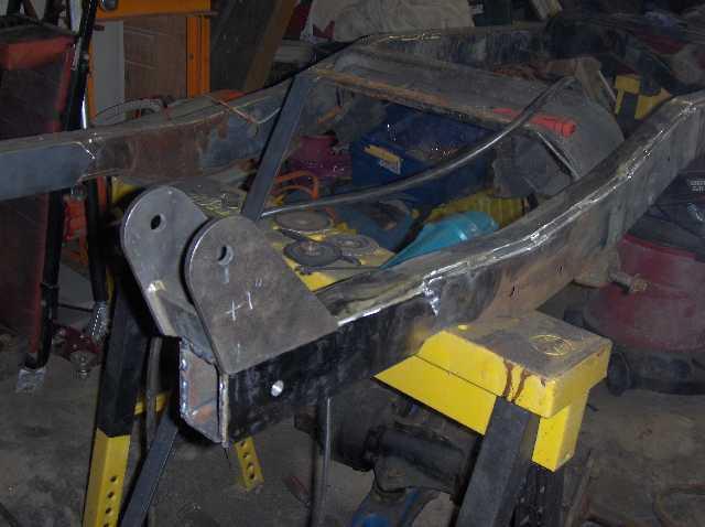

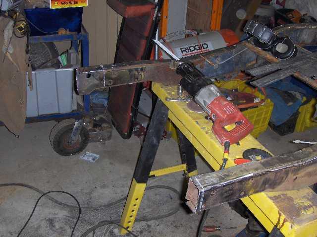

got some more done on the frame. managed to clean off about 100 pounds of bumpers and un needed brackets. Cut the first 4" off of the front rails and added 6" of frame tubing to get back to 84" wheelbase. tomorrow night I should be able to get the straping on the bottom rail and the fishplates on the sides. For some reason the neighbors dont like the sounds of progress at night(chopsaw) :booo:

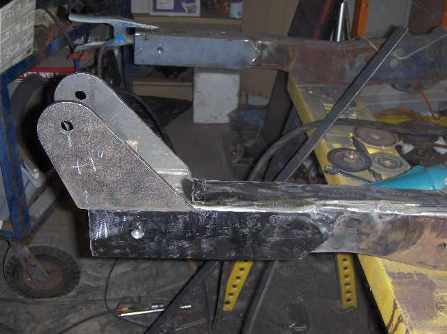

tonights labor of love:eeek:
