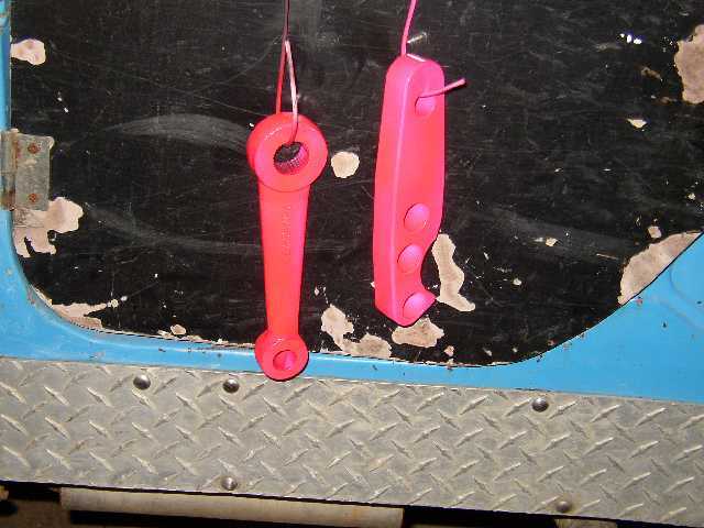

Don't mean to take the subject off Jim's pink thong panties that double as depends but I was under the impression that powder coating steering arms was a big no no. Are the holes and mounting surface not coated or cleaned after?
from the sky manufacturing site:
We do not Powder Coat Steering arms!
Powder Coating steering arms is very Dangerous. Why, #1 because metal to metal contact area's should not have a weaker cushion between them to wear out, causing arms to become loose, and deadly. #2, Conical washers will not seat correctly, neither will your tie rods ends.
you can tape off or plug any holes or areas you dont want coated..... stupid statement

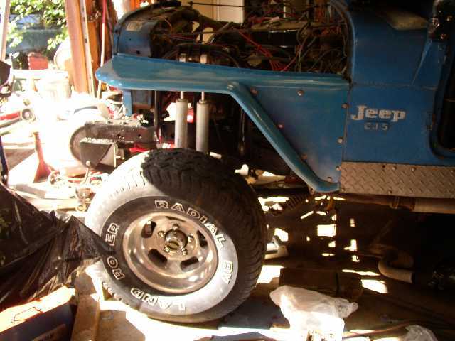

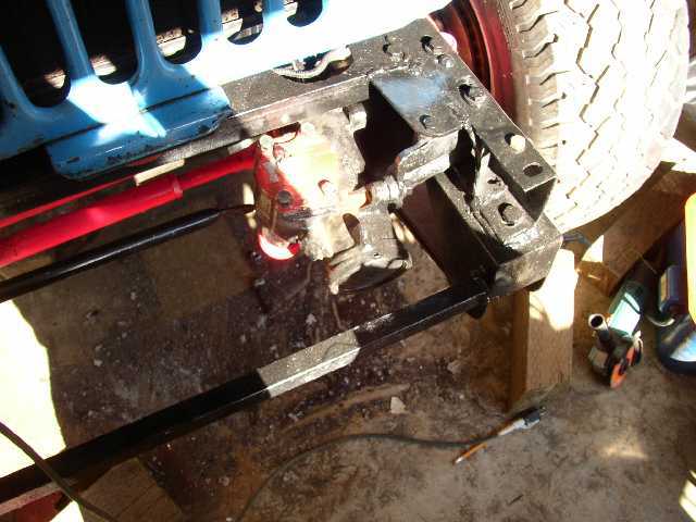

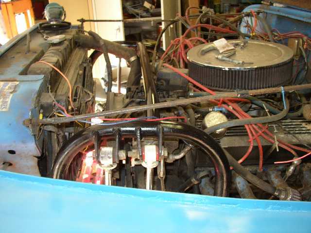

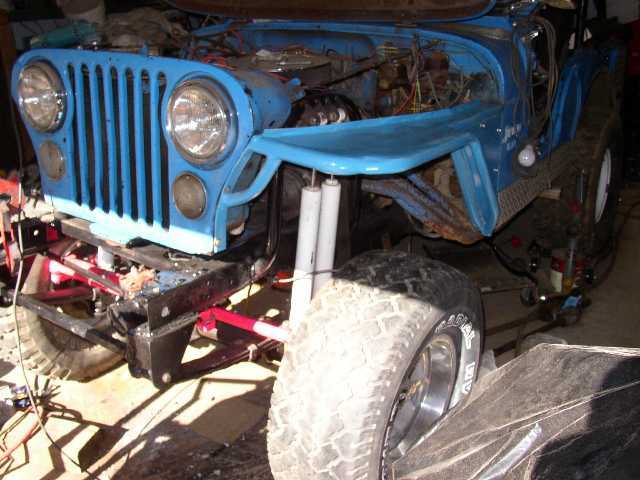

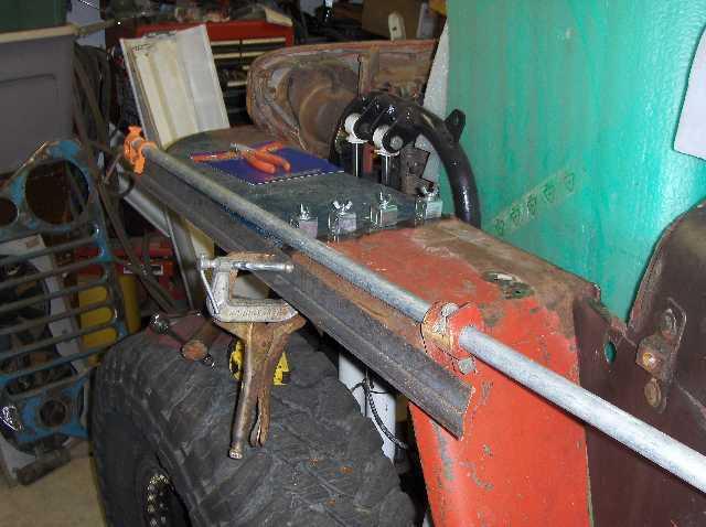

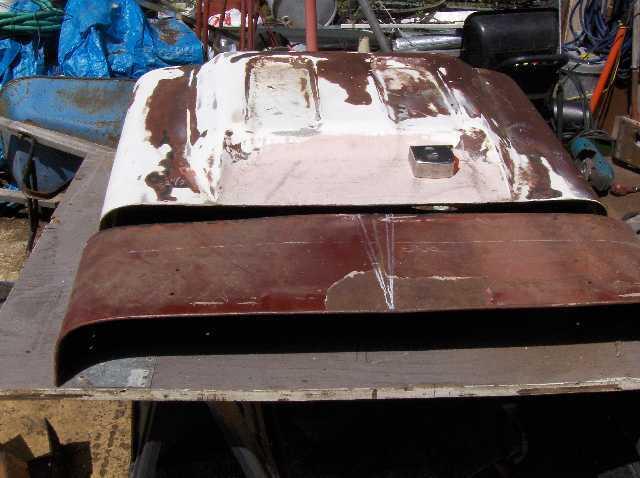

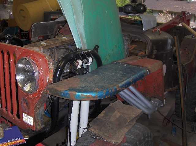

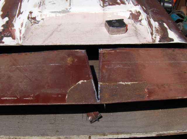

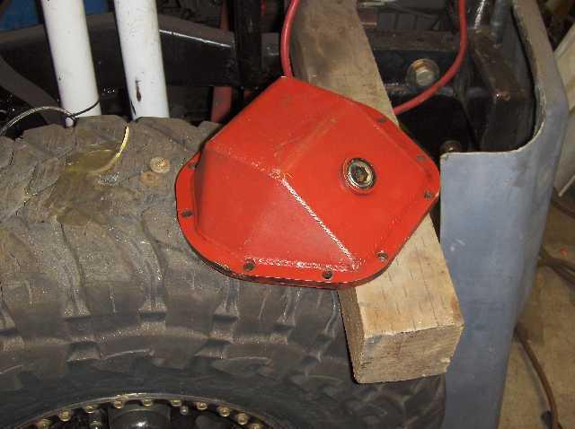

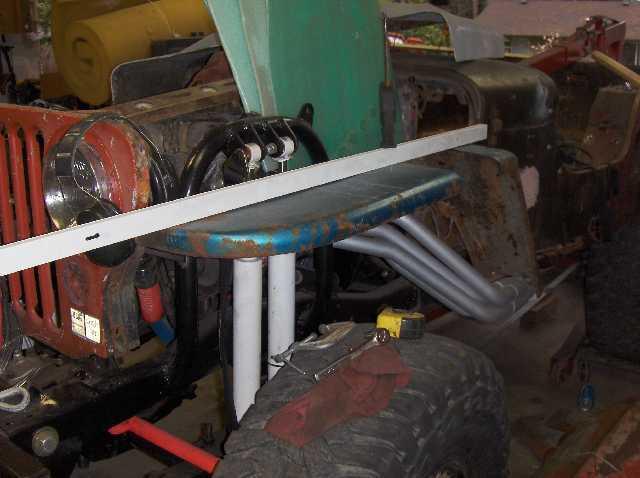

well since I couldnt go out and play this weekend I decided to live in the shop all weekend Actualy got a few things buttoned up and finaly got going on the passenger fender until I discovered at 5:00 pm I didnt have enough sheetmetal to finish:booo: But the drivers side is done as well as the brace between the shock towers. Also finished up the front bumper and winch mount. Got the high steer stuff all finished and a rough alingment. Had to move the steering box forward about 3/4" so the pittman arm didnt drag on the tierod hate those kinds of suprises.
