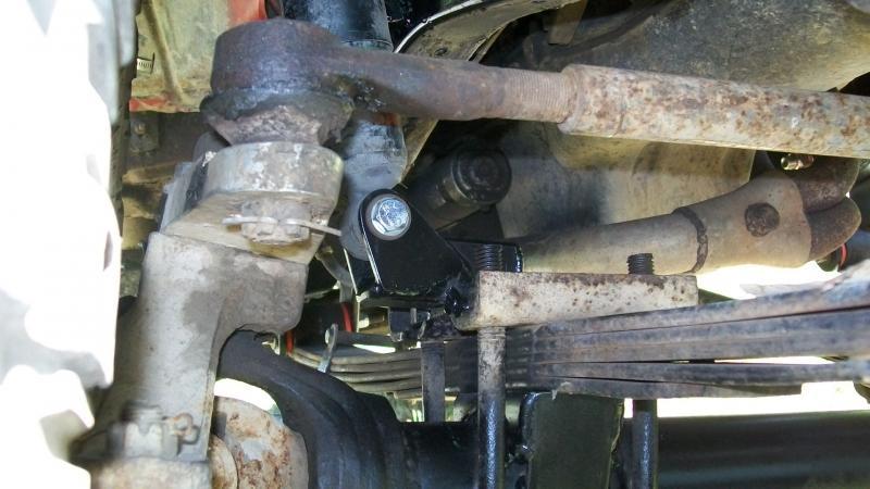

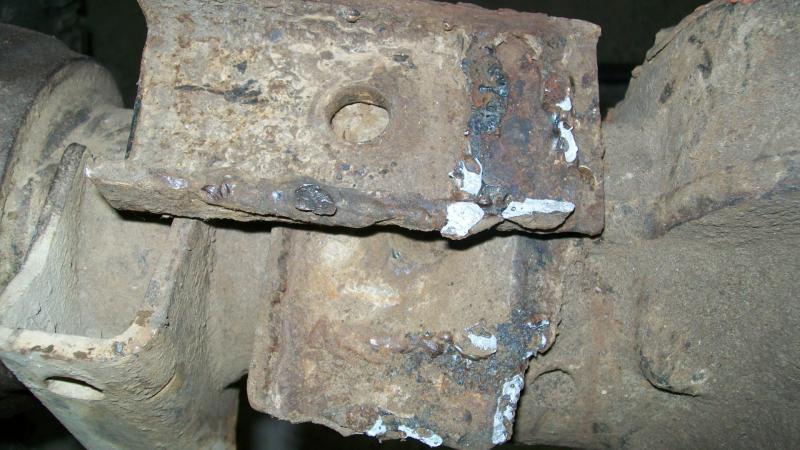

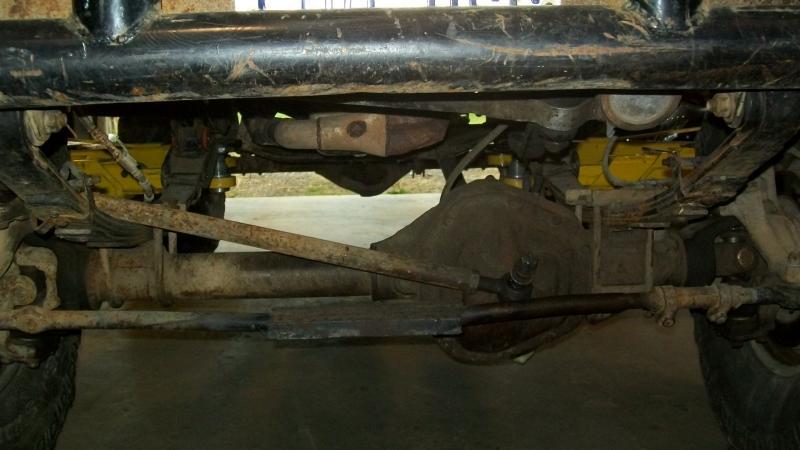

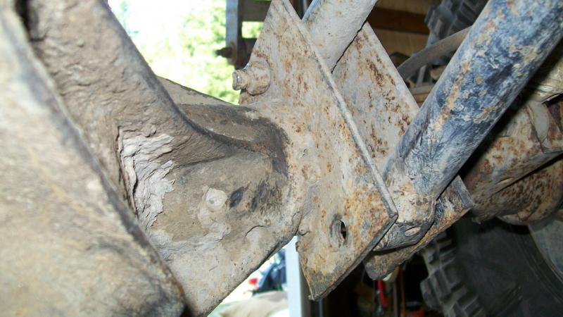

Few pics of the front...Old stuff; Someone had put on the homemade shims, to try and correct the pinion/caster for the shackle mounts being under the frame...barely held on! :yikes: Next run of pics will be of the reconfiguration, which settled several geometry issues...

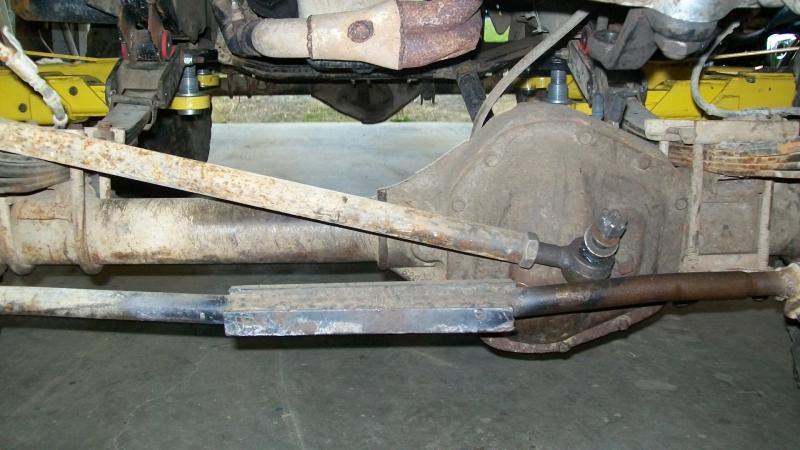

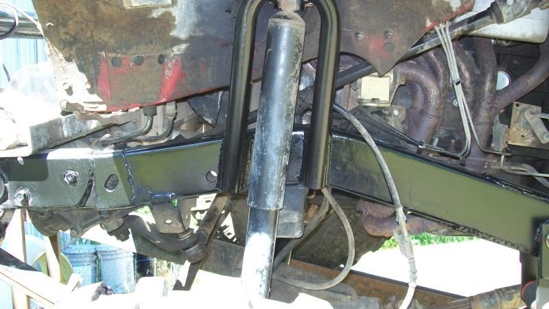

Some of the new configuration...and it's actually got shocks up front now! :awesomework: :redneck:
Ended up with approx 5.5* caster...:awesomework: sits almost 2" lower up front, and the front axle is nearly centered under there now, springs are centered under the frame--- left side used to sit nearly 1.5" to the left with the way the old stuff was set up, moving the axle almost an inch over...all that's fixed now...

The Tie rod and drag link are also getting replaced as soon as parts show up...Anyone need any custom steering parts for spares???:redneck:

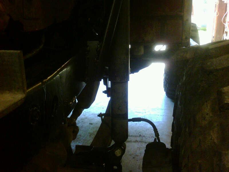

One other thing I need to address, Due to the lack of room on the pass side from the axle being narrowed abit too much, the lower shock mounts ended up on top of the spring plates...gonna devise some sort of support for the bottom of the shock mount...Not sure it's totally necessary, but overkill is better that broken....:cool:

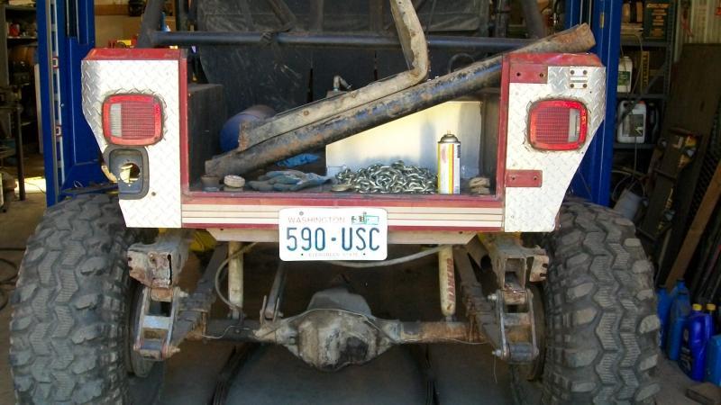

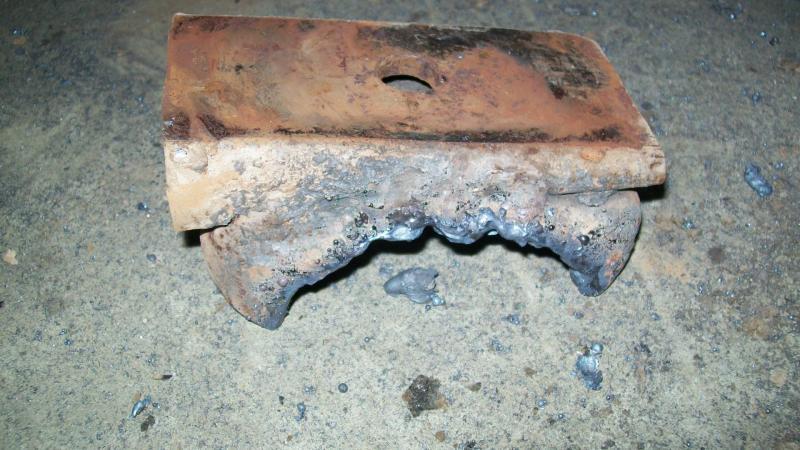

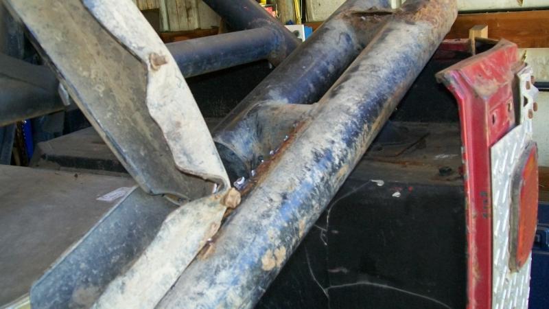

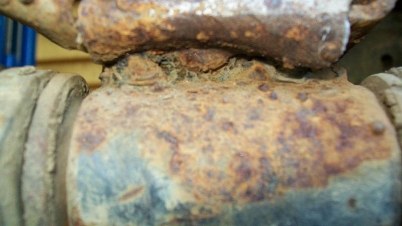

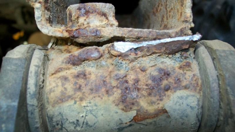

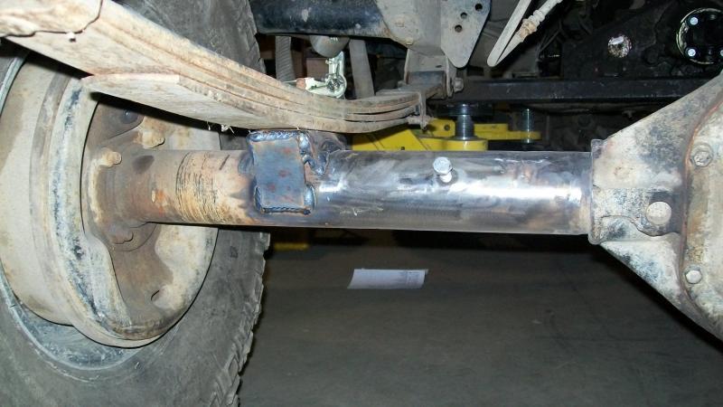

Well, first order of the day out back was to get the rear bumper removed. The welds on this weren't much better than the front spring perches were. So, for giggles, I decided to see just how strong they were! Wrapped a strap around a tree, hooked chain to strap and to each end of the bumper...and gave her a tug! :redneck: The welds themselves held ok, but what it was welded to? Let's just say body mount sheetmetal and the stock rear crossmember is not a good place to weld a bumper to! :haha:
The upside is once I got all that crap outta the way & the frame horns cleaned up, it gave me a clean slate to build from! :D

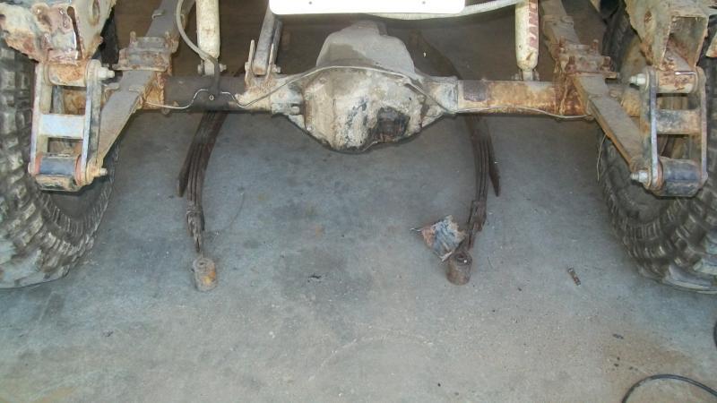

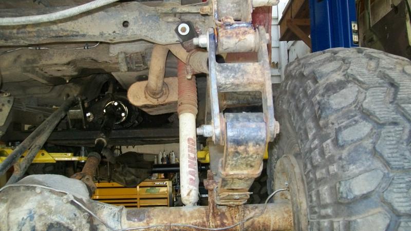

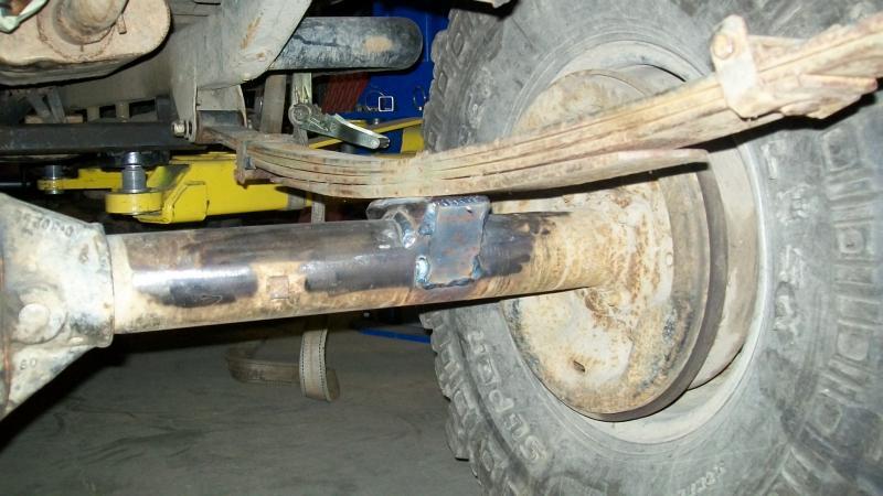

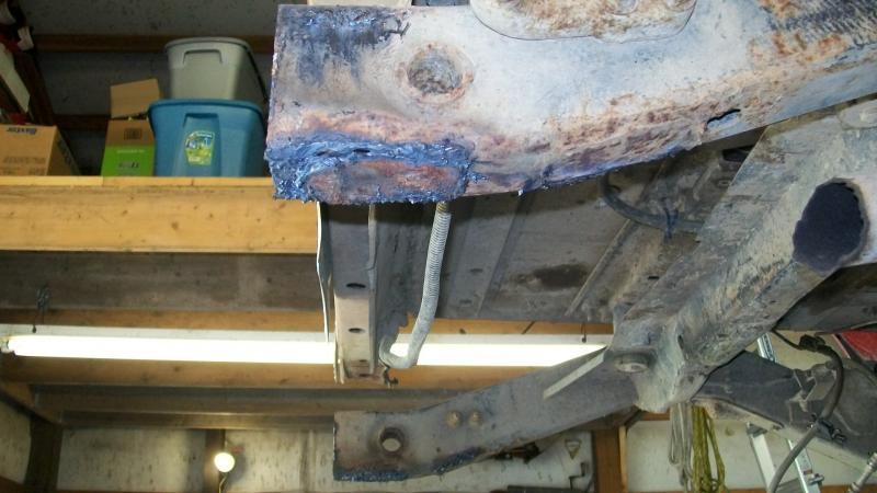

Some pics of the whacked out rear setup...Both rear eyes of the springs were outboard nearly an inch from under the frame. The antiwrap bar had sheared the lower bolt off the axles end some time ago, killing the springs....

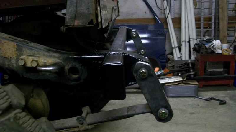

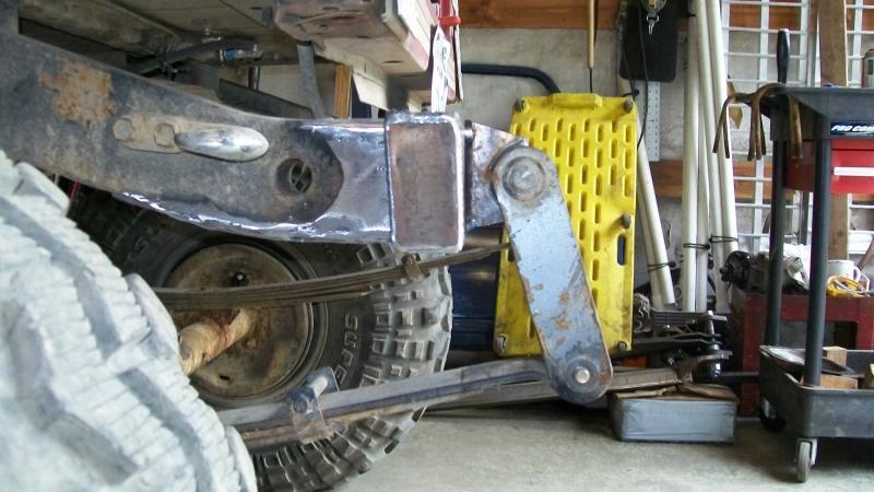

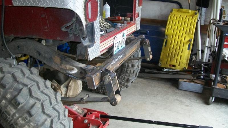

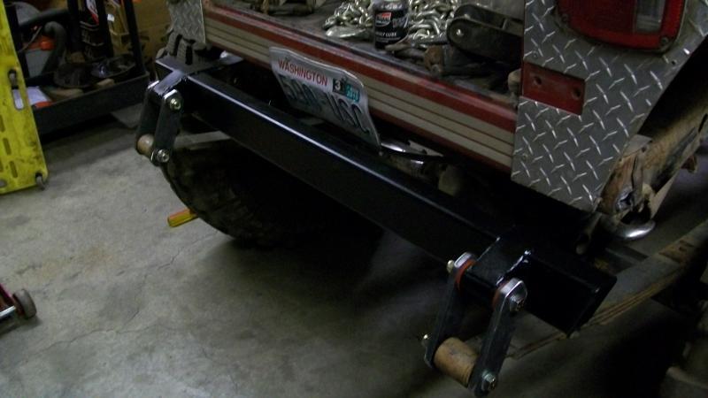

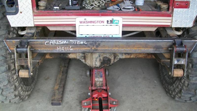

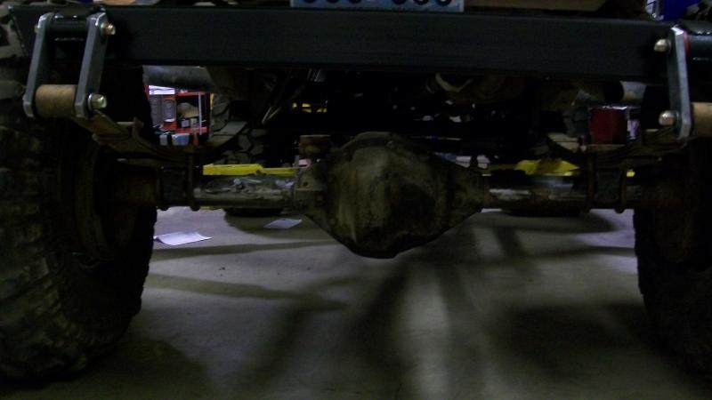

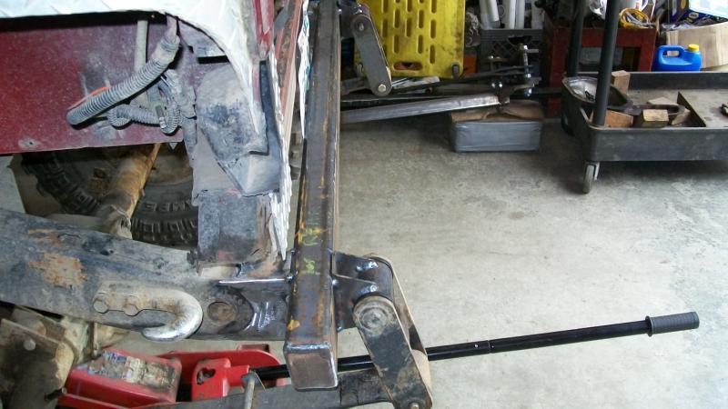

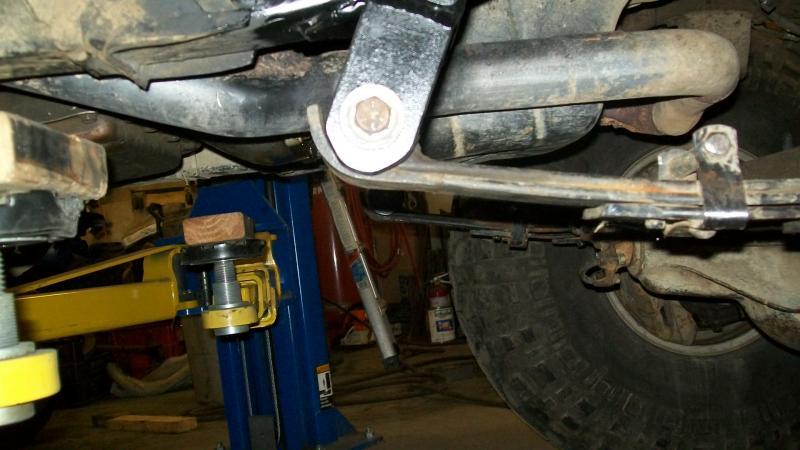

Now, with the dirty work past me, here's a few pics of what's to be the rear setup...Got into a groove, so not many pics during the process...
Slung the new leaves under the rig using the original shackles, tacked up the rear bumper, and made up a set of shackle hangers and got them tacked in place. set the rig down on the axle to get a look at the rear height...a little high yet, and the shackle angle is close but not quite to my liking....easy fix though.:;

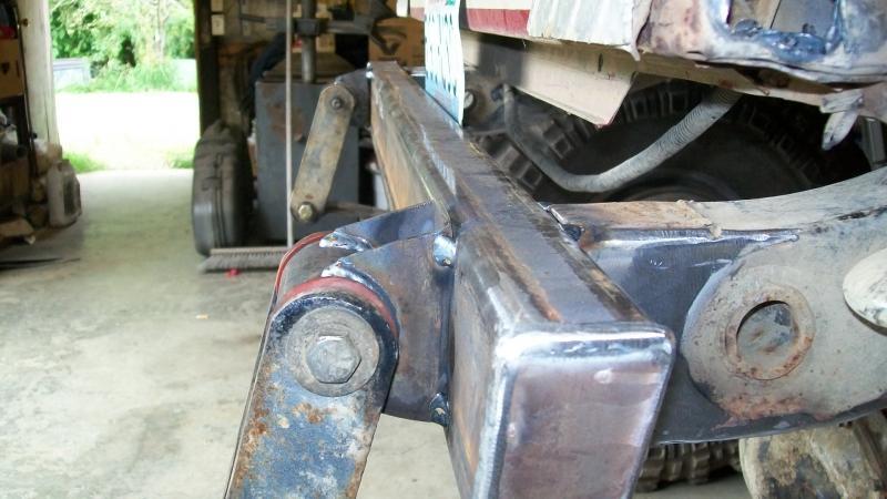

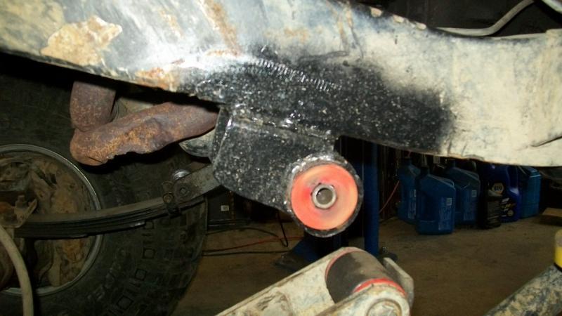

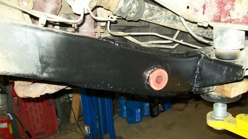

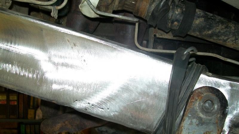

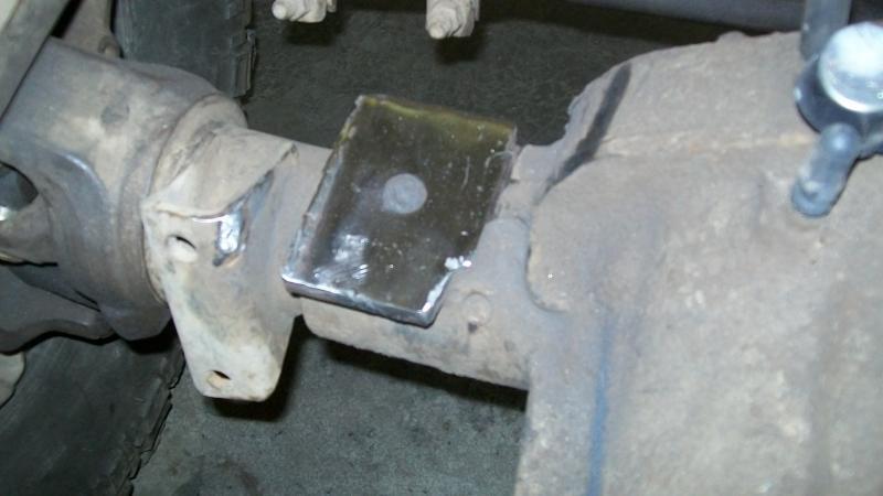

Decided to make up a set of shorter shackles from 1/2" flat stock, and picked up new hardware for mounting them. Also plated the top/bottom of the frame, tying everything together while cleaning up the look at the same time... One other thing I had to address was the right spring perch was welded on crooked, so I cut the not so good welds on one side of the perch (no surprise there), and the damn thing nearly fell of in my hand, so I just popped it off the tube. Cleaned up the tube, re-welded the perch in the proper location, and beefed the perches up a bit...Decided after that incident, I better grind the other side and reweld/beef it up it as well.... Mucho betta all the way around! :awesomework:
With all said and done, sits approx 1.5" lower out back now....:awesomework: might need to add a couple XJ leaves to help compensate for trail gear being loaded in back, but we'll see....I like the nearly level stance as it sits!:cool:

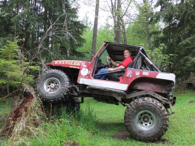

Took the rig to the Rainier Ridge Rams Show 'n Shine. We still don't have the rear suspension dialed in, but it ramped 960 on a 20* ramp.
