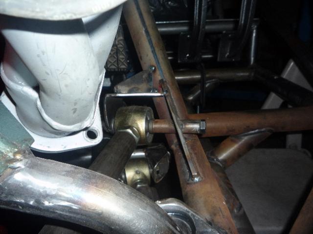

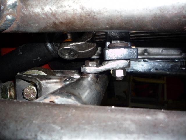

i think i could do beter with a brake. bounced around some today, finished the pillow block adapter bracket.

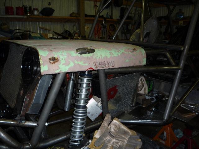

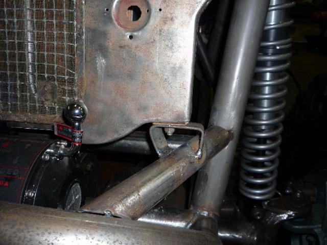

cut the bottom of the grill around the winch some. i need some 1/4" round stock to give it back some strength. folded the seams on the original hood and i do believe i will be able to use it. ill have to open the top for the shock hoops some.

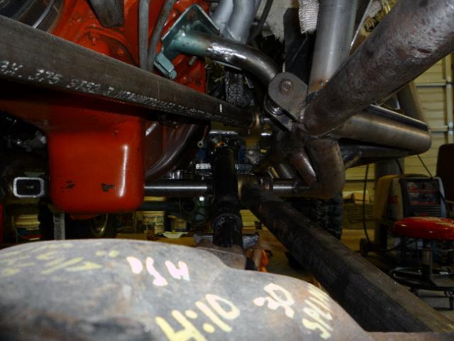

looks good for the best results on the pillow block the ujoint should pivot with johnny joint not before or after the johnny joint, does that make sense.:redneck:
yeah it does, the front end is still floating as i dont have the yoke for the front yet. i can slide the shaft to where i want the u joint to be by the length of the front half. i believe it will be correct when all there. that had been the plan.

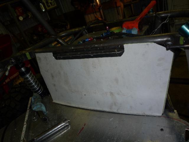

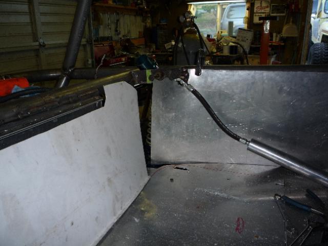

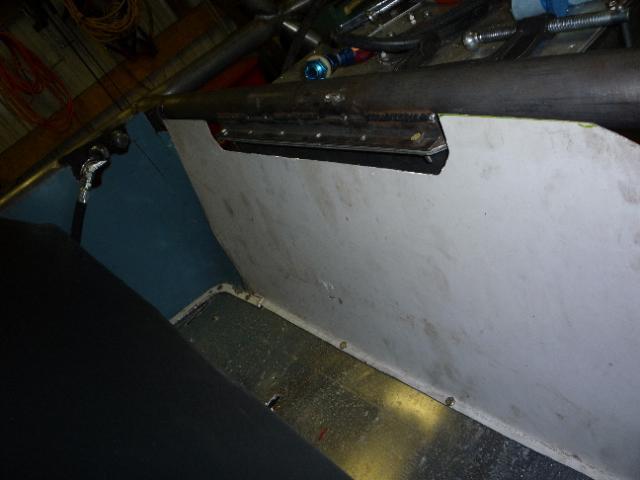

fought with sheetmetal all day today, ended up remaking the rear inside panels again but i like these much better. ill post pictures after i get some dinner.
the blue and white are just the prepainted surfaces of the same 20 Ga aluminium sheetmetal. my fingers are now all sliced up, i swear i have a hundred little cuts.
it will get skinned on the outside also but i wanted something to keep the crap from the wheels getting in the people compartment.
i need to flex it out with all this crap in place to see what rubs, im worried about droop and springs hitting the bottom of my tub.

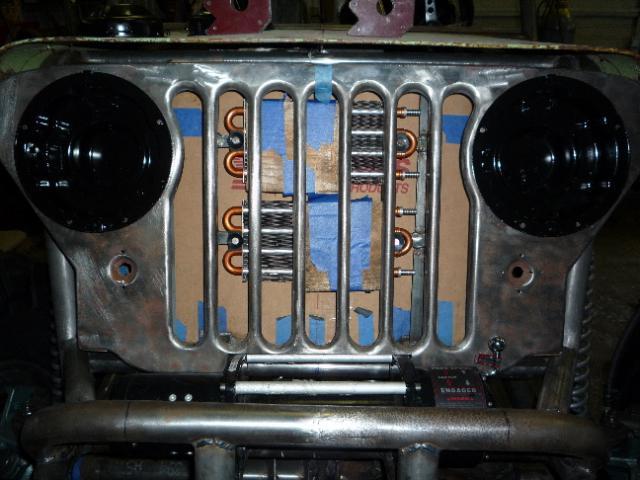

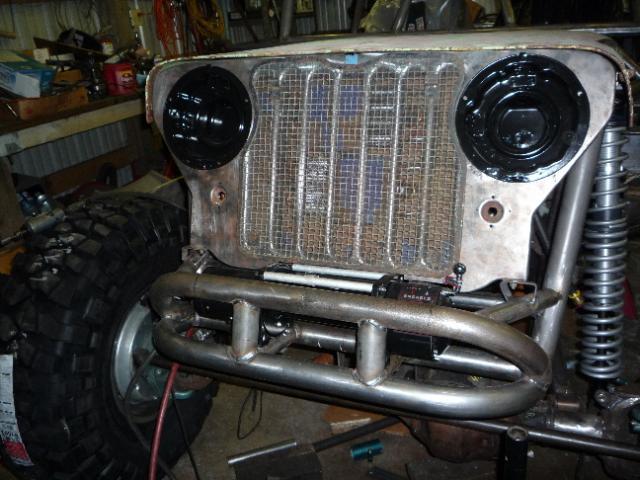

lower grill mounts.
final grill and hood fit.

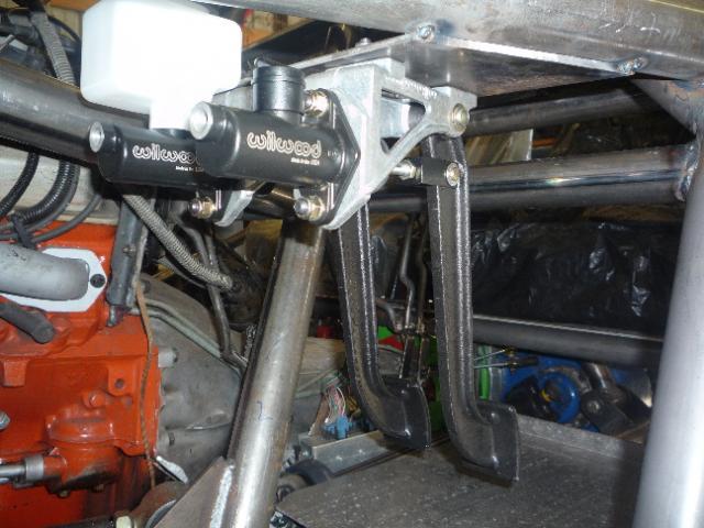

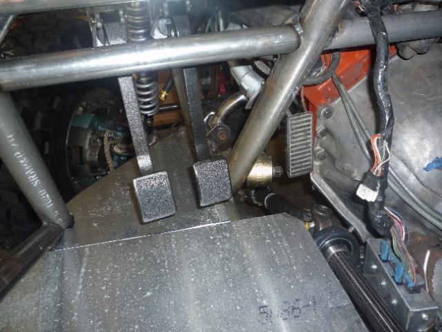

brake pedals:
one will have to have a remote resevoir but it came with:D

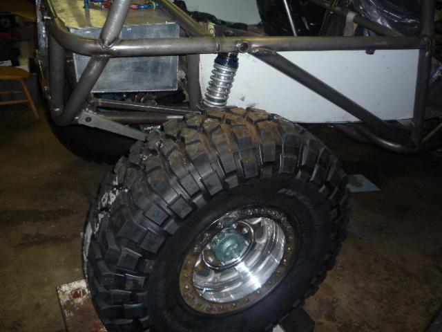

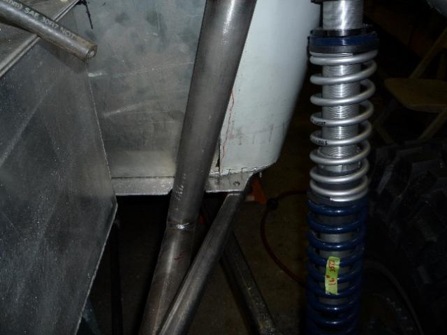

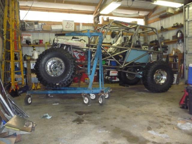

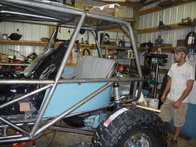

flexing it out as best we can in the shop:

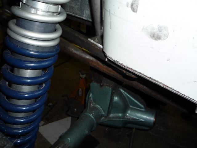

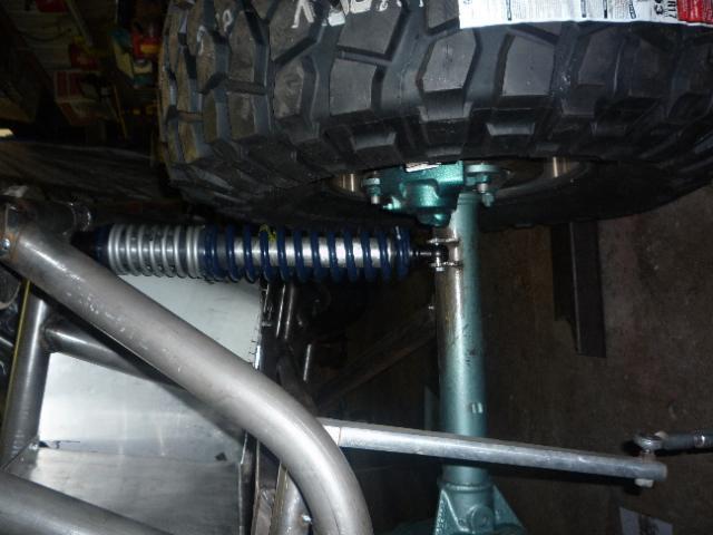

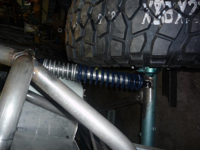

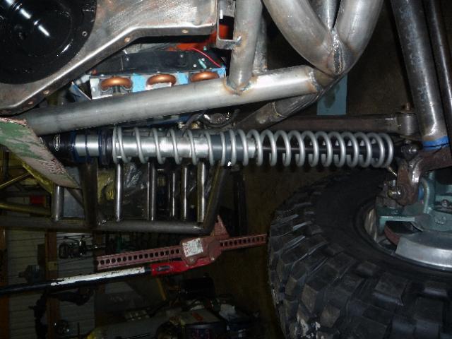

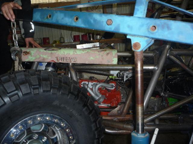

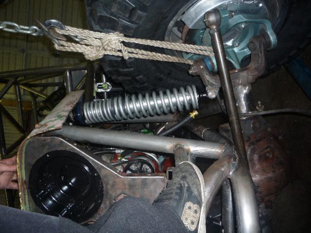

Front tire to spring clearance, spring to chassis clearance. check.:D

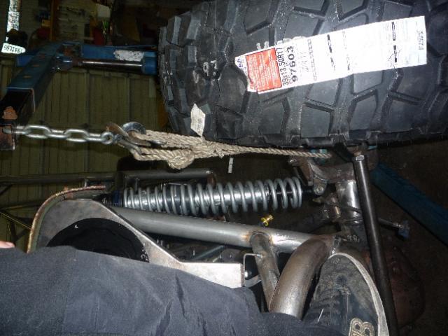

rear spring to tire clearance:eeek: looks like an adjustment to be made here as the tire hits the spring when the frame is twisted up with a hilift as well as the tire pic, at complete stuff, shock on the rubber bump.

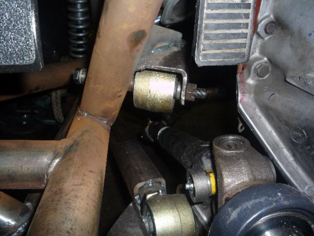

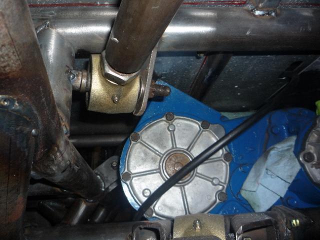

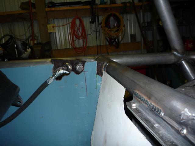

one more at full stuff. the double shear for the upper link mounts. need to get paint on this thing soon. all the rust is from where i have been touching it a lot lately, lot of work right above the drivers feet area and below. i guess you could say ive been working my whilly into a rash.:haha:
