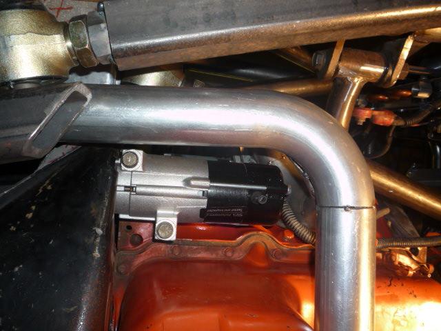

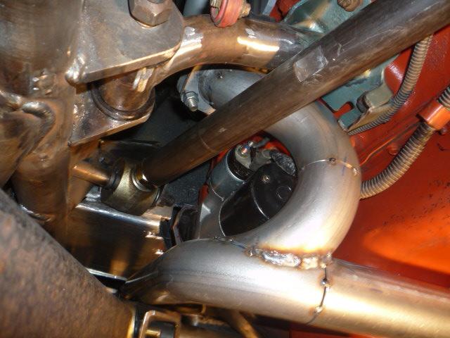

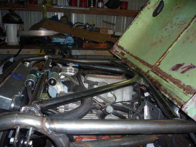

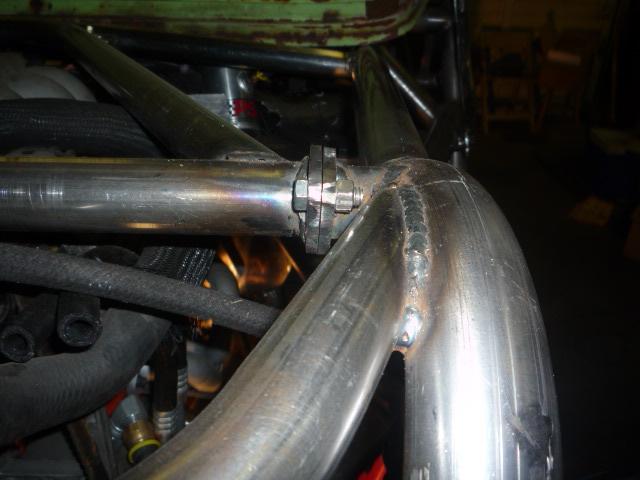

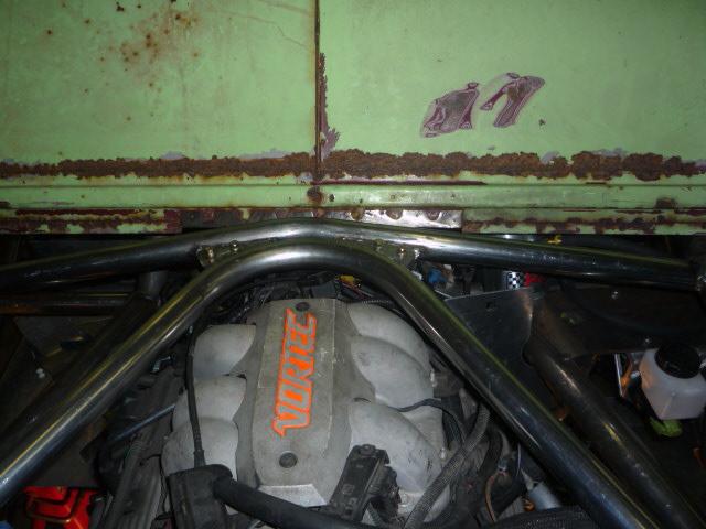

made some proggress over the last two weeks.
made the top engine cross brace.

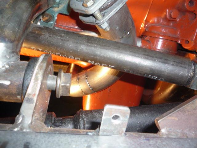

Made exhaust again as i didnt like how it came oth the first time using crushed bends from the store. got two j bends and a u bend from summit.
when you cut into a bend the cross section it is almost perfecly round.:awesomework:
batttery died on the camera before i could get the pictures out.
Notice the slight angle on the flanges so it can hopefully always pop out in the up direction in case there is any stress on it when trying to remove it.
the passenger side exhaust was really tight. im glad i didnt have a driveshaft to deal with also...

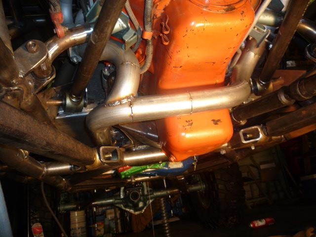

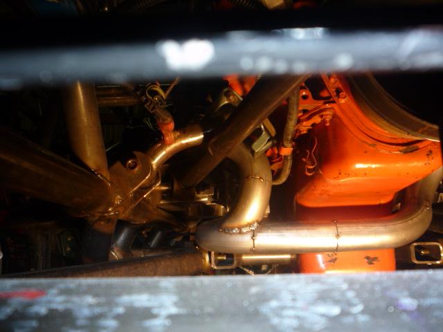

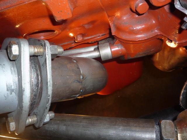

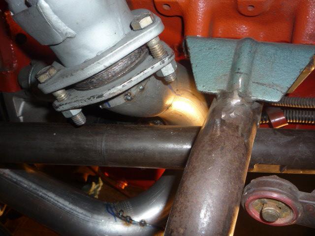

more exhaust.
last parts of exhaust. i believe the starter will drop right out. probably have to pull the engine the get this little WYE pipe out.
Still gottta put in the bung hole and i believe a flange so the rest of the exhaust can un-bolt.:awesomework:
