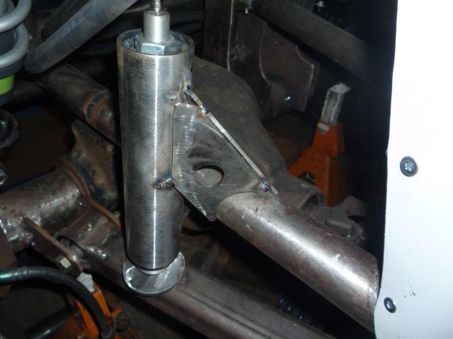

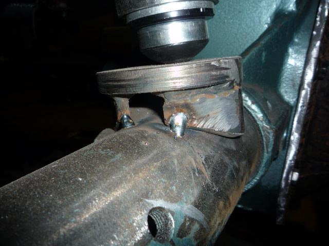

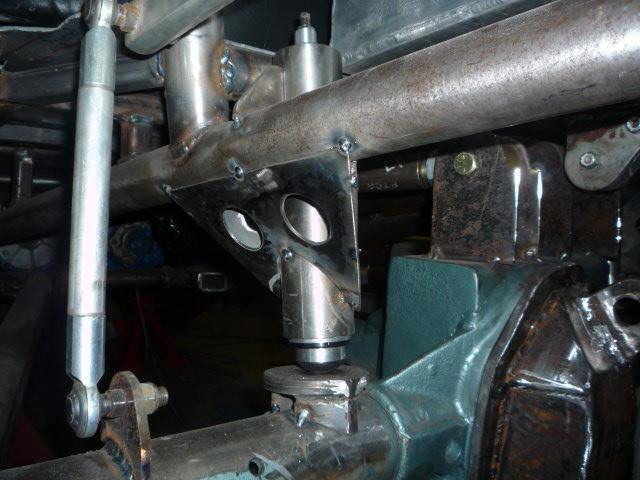

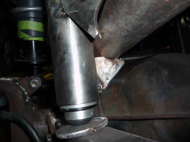

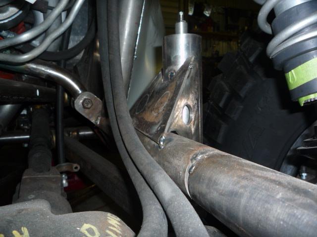

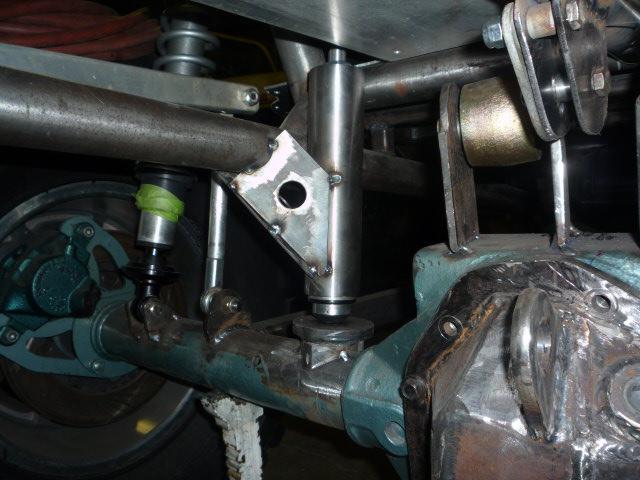

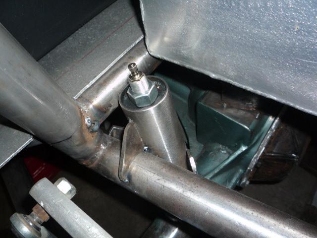

yeah after today ill post a couple pictures of my bump stop mounts. few thing to finish the cowl area, belly pan and lots of little things.
bump stop mounts

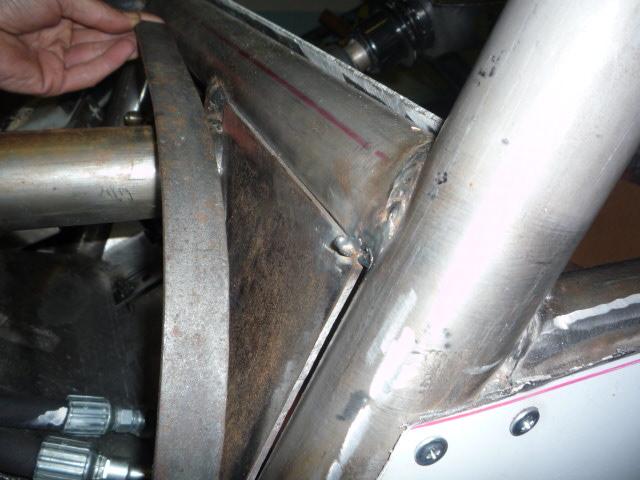

more bumps and starting on the cowl area.

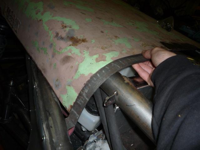

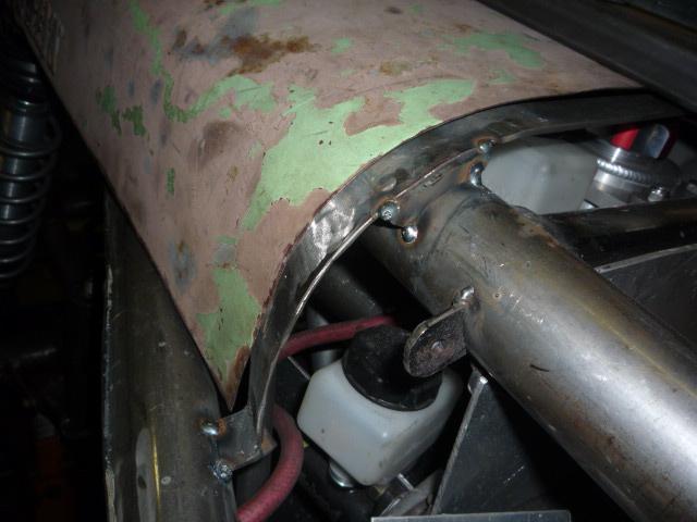

making the starting points and ending points or maybe i should say curves for a cowl piece. two different radius with two different widths. probably gonna make some mistakes with this one:looser:

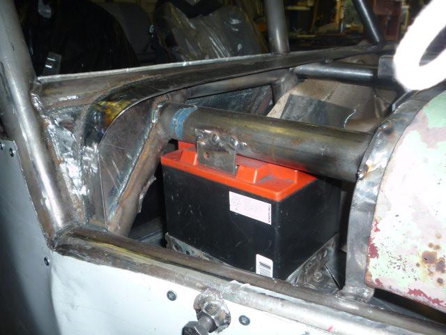

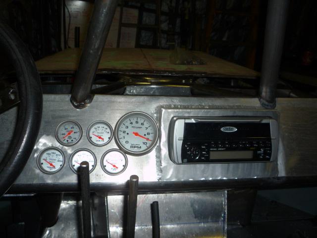

ohh and the little standout for the stereo so i could fit it above the heater.:awesomework:

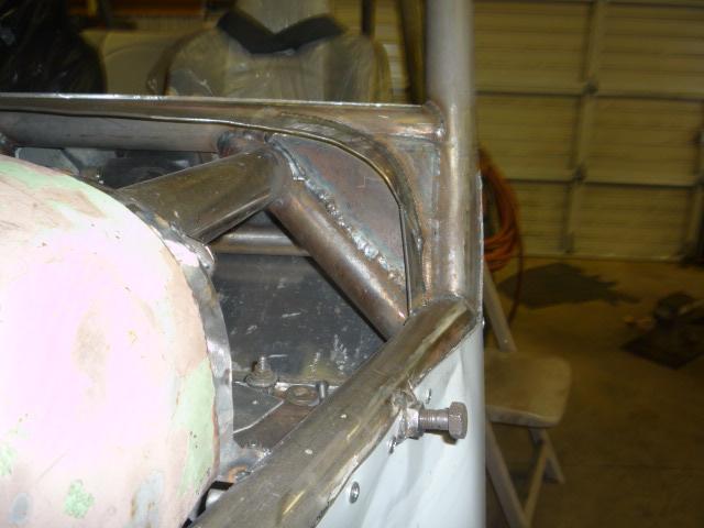

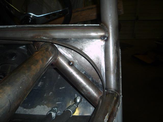

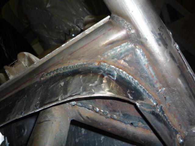

worked on the cowl area
the angled/curved landing areas.

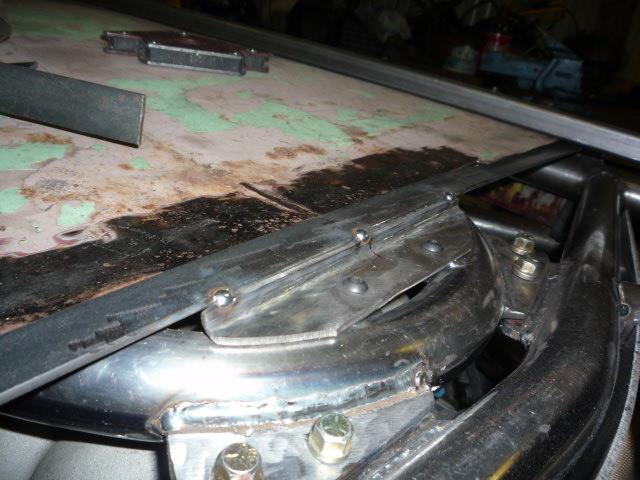

Looks good Hip. Is the third pic (last set) your hood hinge ? Looks like your setting it up for a folding windshield as well:eeek:
yes plan on having a windshield, i already made the frame for it but lost interest as i want to get it to run then i can finish dodads and stuff like windshield, wipers, roofrack for expedition type camping.
last night when i took the pictures i rechecked the angles between the two landing areas and the large one must of warped when welding as the angle is no longer perfect.:looser:
