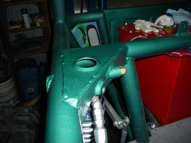

Something new to show. every buggy has to have dimple dies its a fashion statement.:fawkdancesmiley:
