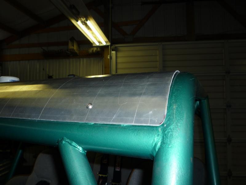

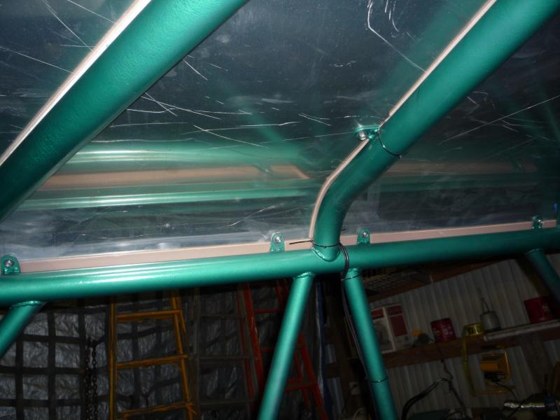

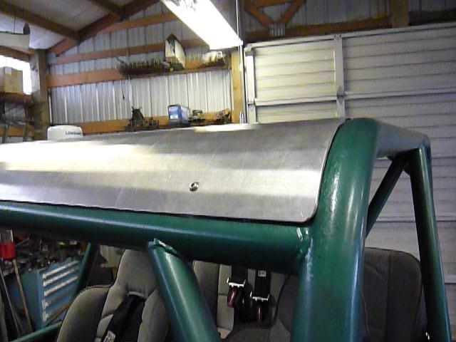

so i got the roof fit and installed, also the antenneas for gps and race radio.

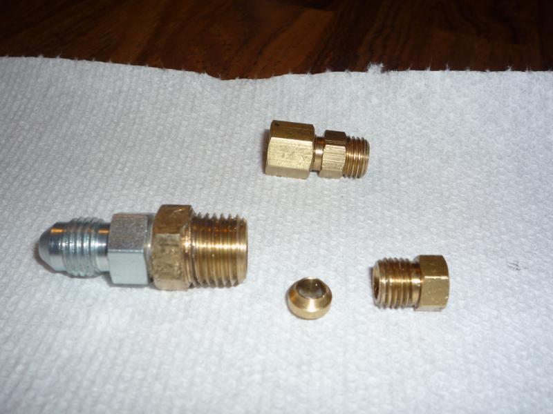

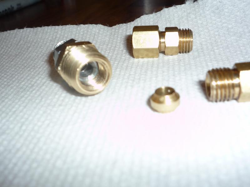

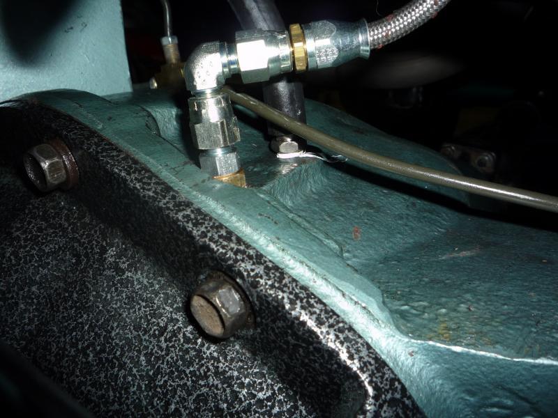

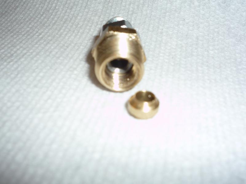

I have one question...Why build custom ARB fittings? Are you building trail spares? Seems to me you'd want something simple, so finding it in a pinch at the local hardware/fitting store isn't an issue...:eeek:
Roof looks awesome though!:awesomework:
so it dont break on the trail EVER. it came out great, most bulletproof setup ive seen with my eyes. :flipoff:this setup will eliminate the little brass fitting above the other three.

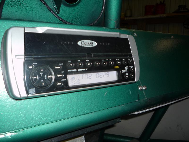

Srereo works
Stereo works great i just need to find some rear speakers.

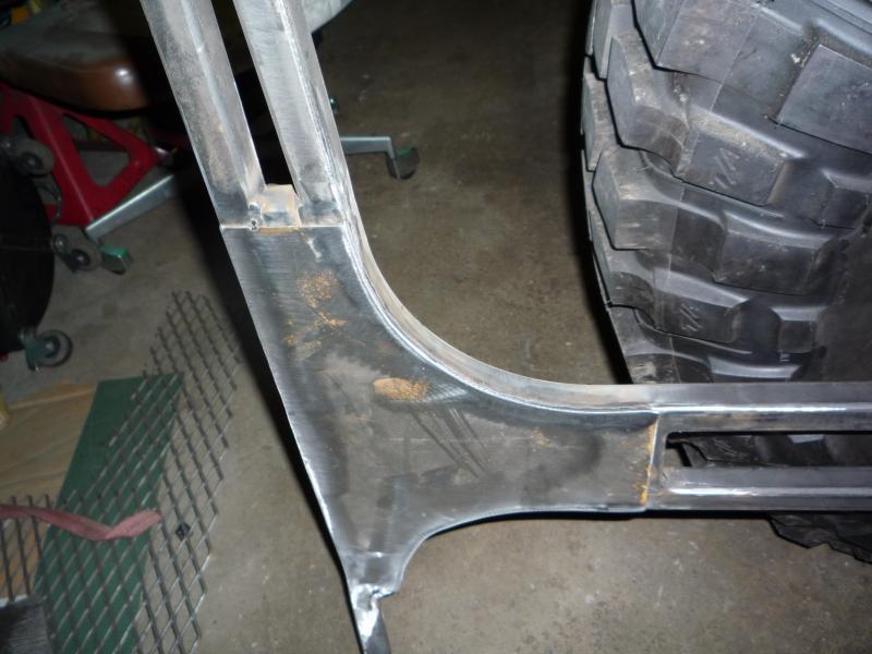

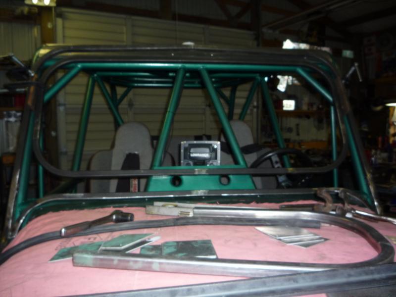

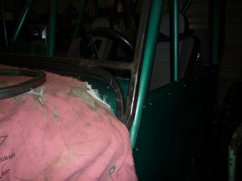

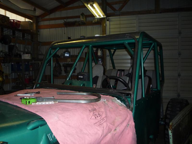

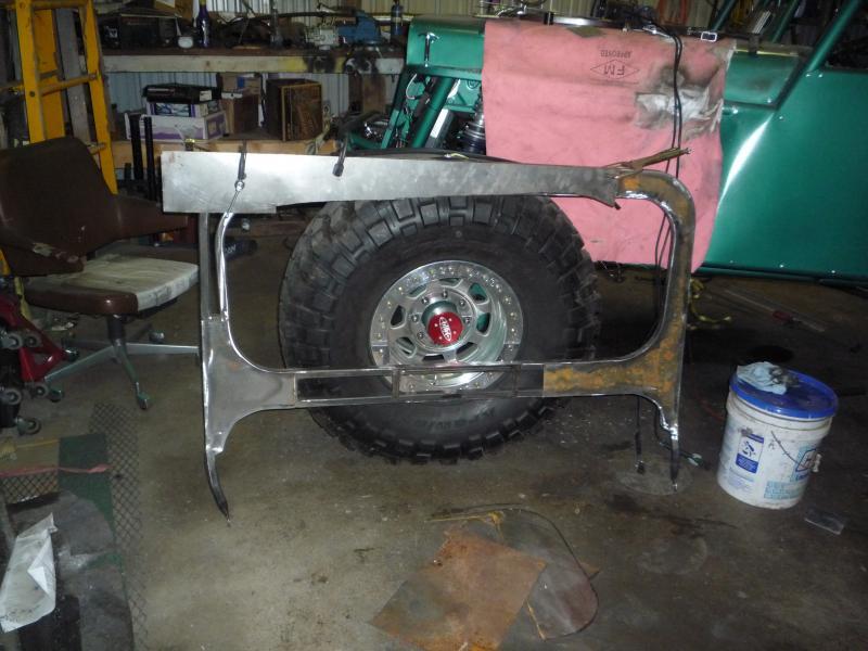

windshield frame is one of last major pieces
got the front done and wiper motors in place
ran out of sheetmetal.
yeah what he said...^

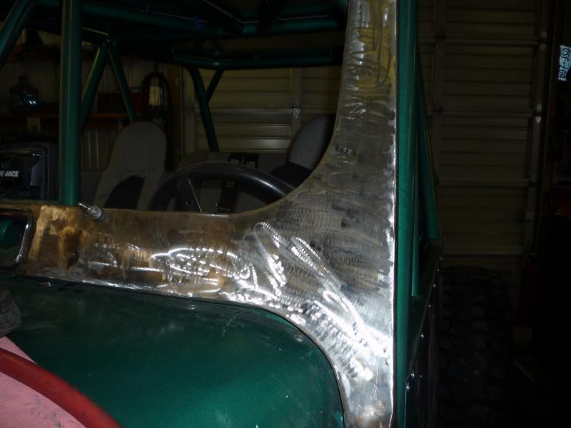

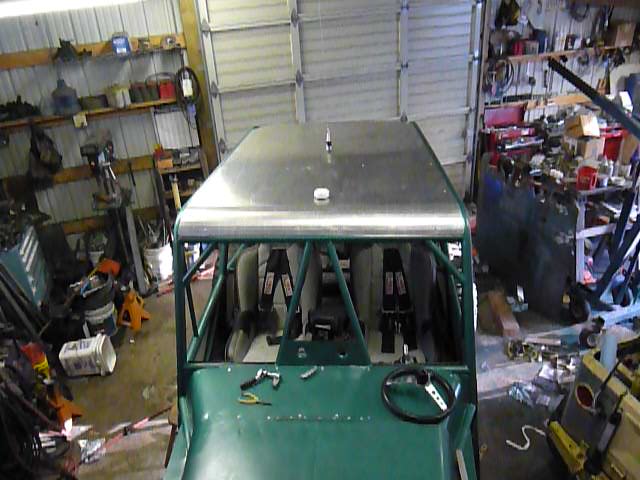

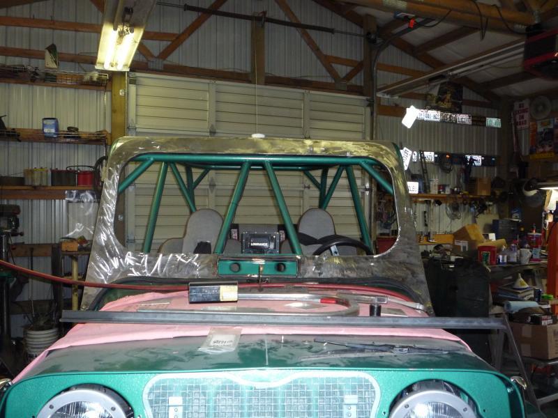

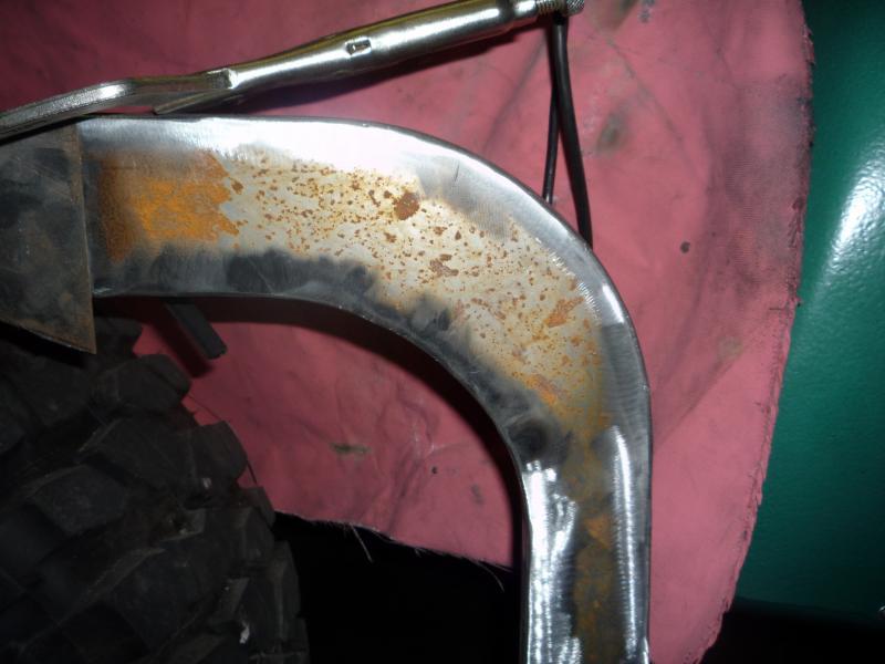

My plan was to use this entire piece from the old frame but when i went to actually cut it i realized how trashed it really was, i was barely able to salvage the vent part.:redneck:

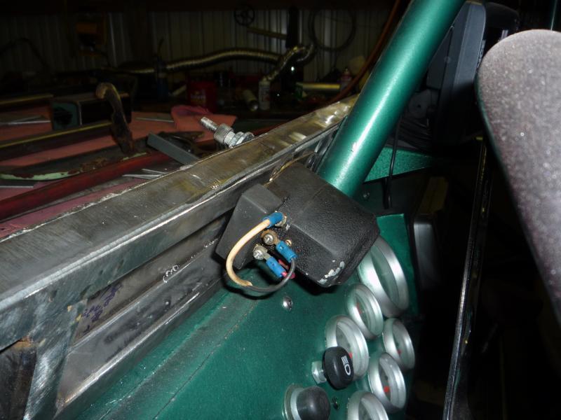

i made a couple of speed holes to allow the air in on my gps mount and the wiper motors fit on the other side of the A pillars. i had an old seal laying around and it fits perfect under the frame to seal against the cowl. well maybe not perfect but itll do. need one more piece of sheetmetal for the inside and to leave the landing for the glass. of course it removable for big dog days.....:haha:
i hate getting hit in the face with wet berry bushes. well that and the fact i could not breath when trying to speed test it....been a long time since i rode motorcycles i forgot how.:D
I am lovin' it! I would rather have the glass than goggles:awesomework:

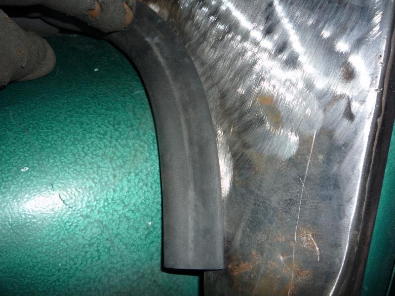

Little tip. Try to seal the top of the windshield to roof joint. When I did Fifo's the worst thing was the stream of water that came through the gap. I/ Chad can get some of the bulb weather stripping that goes on a flange for you.
if you notice the top bar of the windshield area bar lands right centered on the front cross bar of the chassis so i can seal it right there with a rubber strip glued to the windshield frame. that same bar is where the clamps are going to pull the two bars together.:awesomework:
