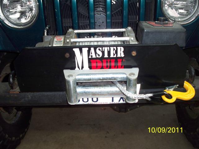

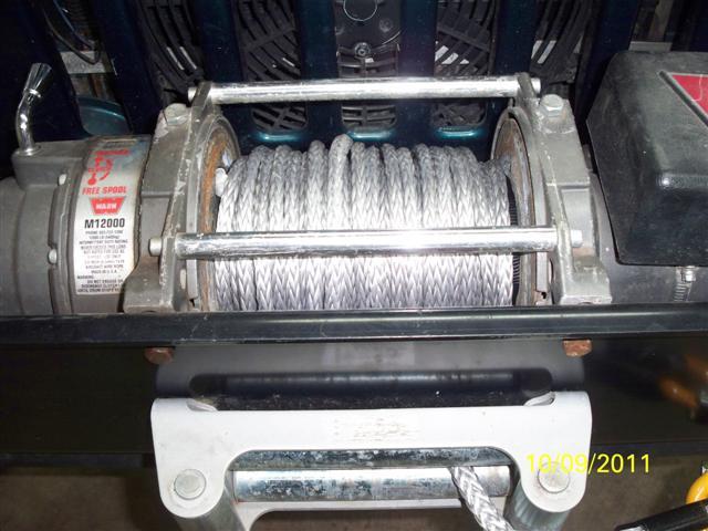

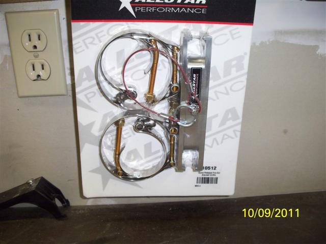

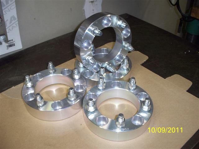

Thankyou for the offer to borrow spacers. Hopefully I won't need 'em, as I've got a complete set now. Pics of spacers, pics of what will become my fire extinguisher mounts, and winch as it sits now.

Then I've got to figure out wheels, as the BFG require me to get 20 inch wheels, and if so, what's the minimum backspacing I can get, as the wider tire will still create rubbing issues with the suspension unless I get wheel spacers or 3.5" (or less) backspacing.
