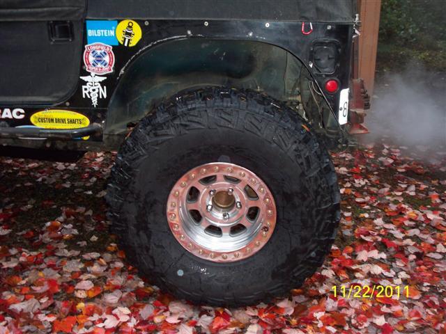

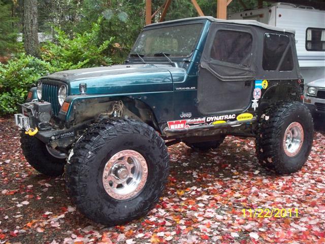

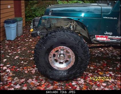

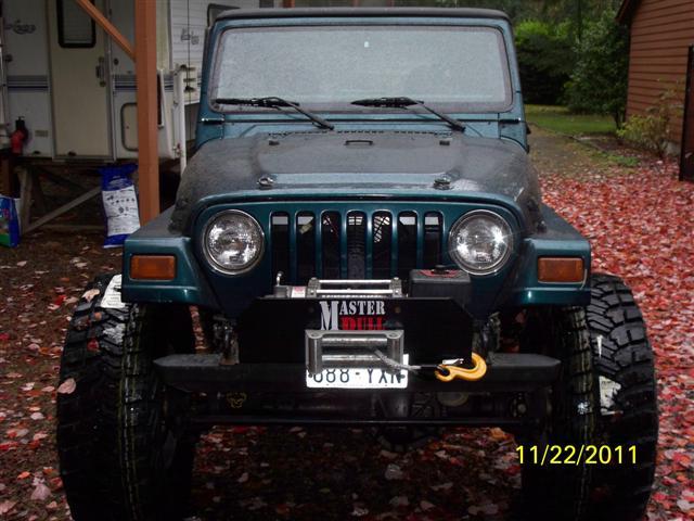

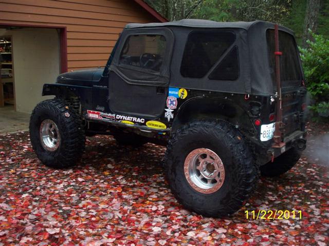

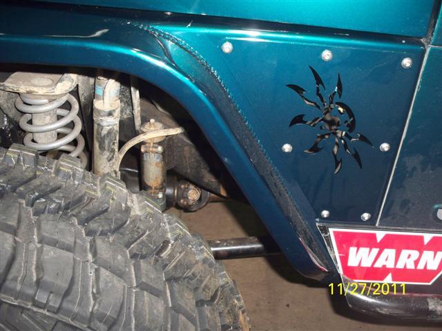

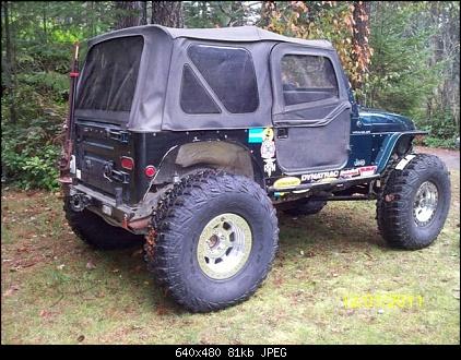

I want to send a big thankyou to the guys at Trailready. Not only did they build a great wheel, but they mounted my tires for me too. Saved a ton of time. Here's the pics with the tires mounted, and a couple closeups of the wheelwells, for clearance pictures. Overall width comes in at juuussst a Gnat's Ass over 80"

Got a few more decals to add to the collection, but I'm holding off putting them on, because I may paint the rockers & rear corners, so I'll put the new stickers on then. Closeups of wheels. I did NOT end up using those wheel spacers from an earlier pic. Didn't need 'em. However I did use some 1/2 spacers in the rear, that Jeepmauler had machined for me a few years ago. It gave me the perfect backspacing. As odd as it is, ideal backspacing for me, is 3.5 front, and 3.0 rear. So I got all the wheels at 3.5 and added the thin rear spacers. Works perfect. Added benefit, my trailer is also 80" wide, so I *should* just fit.
You can clearly see in this picture, that the front tires will have a clearance problem. I've addressed that by getting 'DeFender" front fenders from Poison Spyder Customs. That opens up the fenderwell by another 3 inches behind that front tire, and loses the front overhang (where the blinker light goes). Should have these installed in a couple days.

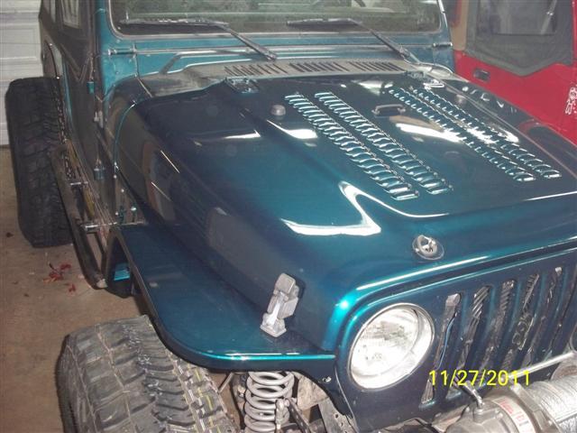

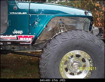

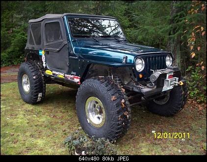

New fenders are on, as is the new hood. Fenders are Poison Spyder Customs 'DeFenders' series fenders. 3" flairs. 3/16ths bent steel. The hood was a spare hood I had, and with my original intentions were to cut the snorkel hole in this hood, in order to keep my OEM hood nice. This hood was louvered by a guy in Tacoma who does hotrods. Anyhow, since I painted the fenders, I also painted this hood. Those of you who know my YJ, will recognize it by the louvers. When I barrel rolled the YJ at Rimrock, it destroyed the hood. So I took all my spare hoods (including this one) and got them all re-louvered. So it's just been sitting around for a couple years.

I have been eyeing those new Poison Spider fenders, they look pretty bad ass. Looks like you had to do some trimming on your rocker guards and tubes to get them to fit.
Good eye. Yes, my rockers were a different vendor's rockers & I had originally added the tube myself. The new fenders open up the wheelwells by 3 additional inches. That created a problem with my prior tube work. Not sure what I'll do. I'm thinking of just capping the end and tying the cap into the rocker. If that looks too fubar, I'll cut all the tube off and put a shorter piece on.

Here's final pics of the DeFenders vs. OEM fenders

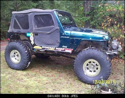

And some poser pics on 40s.
Next stop is the suspension and roll cage mods.
