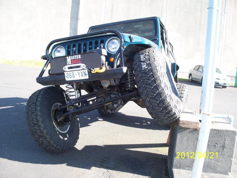

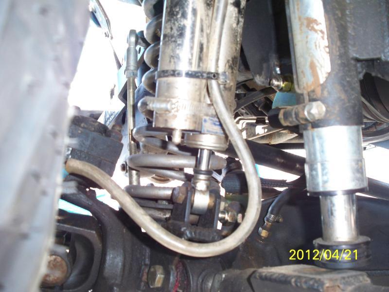

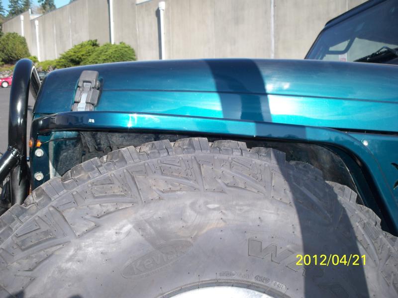

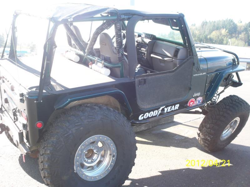

Suspension flex testing
Ramp height 33 inches (30 concrete, 3 inch block wood)
Everything clears nicely, probably could clear 42s.
Going to adjust bump stops accordingly, do some minor relocate of the ground wires on the taillamps, and maybe some tiny trimming in one spot.
Very surprised everything clears nicely.
Still have 1/2 inch uptravel in front, till it hits the fender, but plenty of turning room (behind tire), with 1 inch shock travel left. Should just hit fender, before shocks and bumps limit up travel. Looks like I will have some paint rub. I can live with that.
