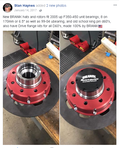

gubni said:The price tag is $450 shipped. That includes calipers, rotors, brackets, pads, and mounting hardware. It allows you to put rear brakes from a 2000 superduty on the front. It also includes a spacer ring that is drilled dual lug pattern 8x170 and 8x6.5 in case you want to redrill to 8x6.5. The weight savings is about 28lbs.
Dirt700 said:I got my kit in the other day, have it at work right now re-drilling it to 8x6.5
