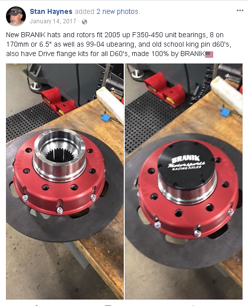

Correct. Burkey sells a kit with Wilwood calipers, those hats and rotors and mounts for around $800 an axle.
That's a nice looking setup from branik. Whenever I build a 14 front in the future I may step up to these. It's just more than I wanted to spend right now trying to build a whole buggy. I have about twice as much gray hair since I started this build lol
