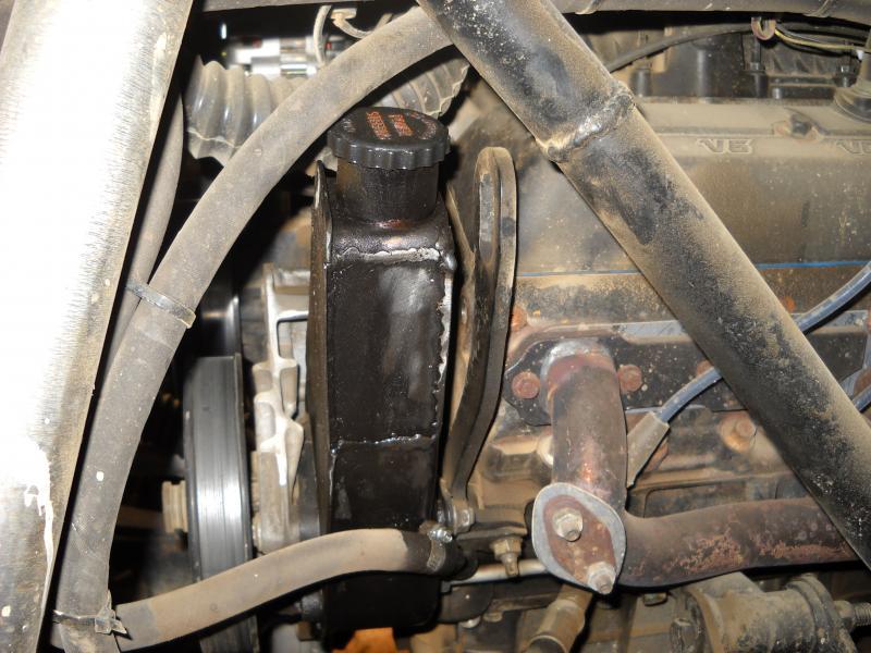

And the res is about double the size of the stock one. You can see the welds where I cut the top off and made it taller. The leaky fluid is from if spilling out the top.

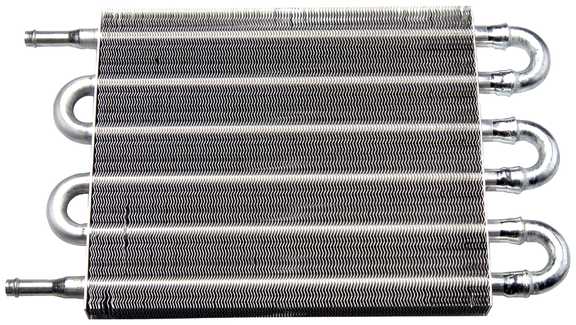

My cooler is this one from napa. Screw the linky, I could get it to work either. The cooler is 7.5"x12" and looks like this.

The NAPA link doesn't work.....What is the hose in the picture that looks like it goes just above the res filler cap?....I know it's not practical but the res is supposed to be the highest point in the system so air bubbles get trapped there. With a stock style pump it's probably not the highest point but you should keep the hoses lower wherever you can and not have any big loops where air can get trapped.
Also, if someone could draw or tell me where in my system the cooler should be for best cooling? I have it on my return line but I am having second thoughts. thats where I thought it went.
I can't post a pic but the cooler should be in the line which returns to the reservoir to a hose barb, not the threaded fitting on the back of the pump......Which makes me wonder how all of your hoses are high pressure if one is going to a hose barb as the steel line won't go over the barb?*EDIT* I see a hose clamp. *EDIT*

The line you see in the pic that goes just above the cap is the pressure line that goes to the orbital. The other 3 lines are routed with it also along the frame bar that runs from the shock tower to the dash tube. I didnt feel good about routing them low cause of the posibility of damage or burning on the header. If I end up getting a aftermarket pump and res I will mount the res up high for sure.
