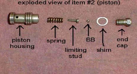

Pic of valve.
So if I do go get a new pump from Napa how many shims to I put under the end cap on the piston. My stock chevy pump had no shims under the end cap but the one I got from napa had 3. If you remove the shims it ups the pressure.

Ok sounds good. I will try a new napa pump with no mods. But if you think about it the P pump came on lots of different rigs Chevy, jeep.. ex.. and I am sure if you looked at all the valves there all shimmed different from the factor but all the pumps are the same. The sim controls how much pressure it puts out. So how do I know what pressure I need for my system?
The shim doesn't control how much pressure the pump puts out it controls at what pressure the fluid is bypassed back into the reservoir. Pumps don't put out pressure, the pressure is created whan there is an obstruction for the fluid to work against. The orbital and the ram create the resistance and the relief valve alows the fluid to bypass the orbitol and rams when the pressure gets too high.
The squealing sound often heard from these pumps is the sound when the relief valve is opening (assuming the belt isn't slipping). If all is well the valve will hardly ever open in the first place.
