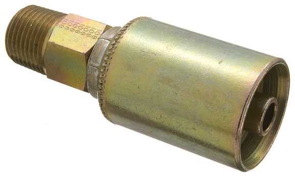

Are your fittings you used the standard ones?
They are the Weather Head Coll-O-Crimp fittings like this one. You push them on and then crimp them with the machine. We use these on all our heavy equipment.
So you don't have any elbo's or anything on the pressure side of the system?
