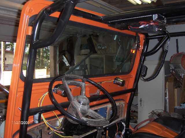

Jim and I had tossed a few ideas on how to do the A-Pillar and he wanted a traditional hoop so a hoop he got. :redneck: This will also allow me to kick out the tube that runs from the A and B billar to help keep the trees off the windshield. boobies
Need to grab a few measurements to make sure the top will fit and then do the b-pillar and support running to the back :;
