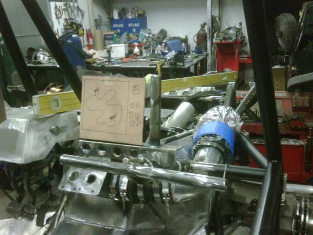

A Picture from the begining of the week. Was waiting for some parts so I built myself a GPS. This should get the job done.

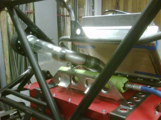

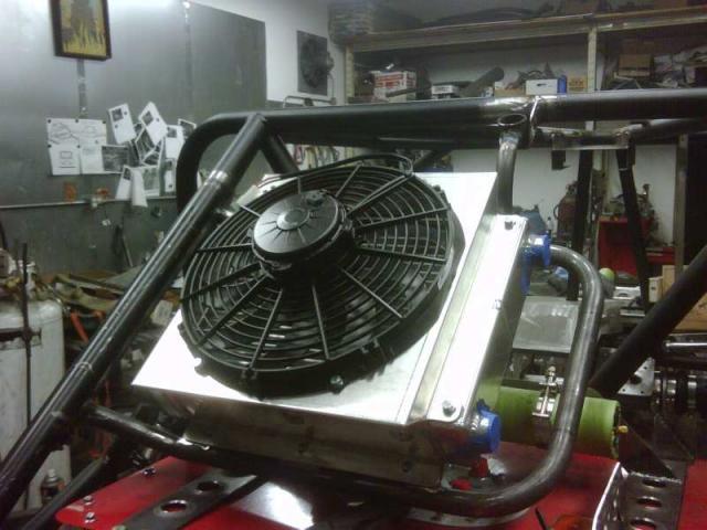

Thanks To Taran/BCC becoming a Vendor for Kartek, the desert racing superstore, www.kartek.com , I got some bad ass parts for going fast in the desert.
One of the parts I got is this new PWR transmission cooler.
Running out of space...

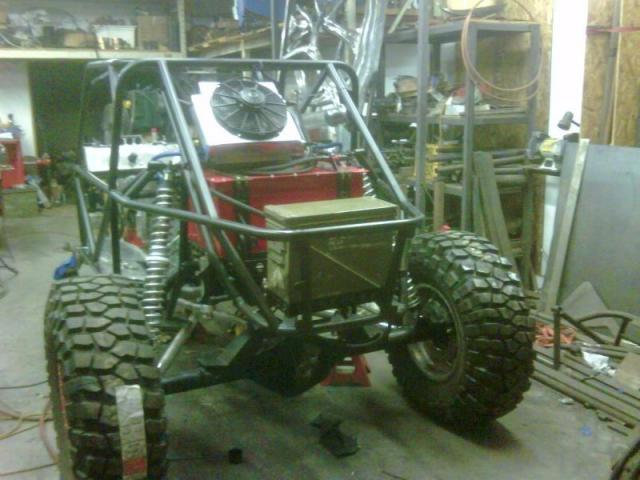

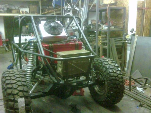

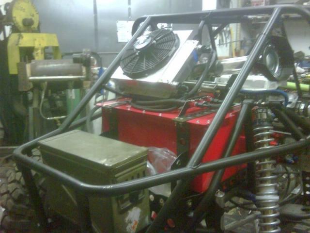

Missing a few small pieces, just need to get them installed: rear tire carrier, rock lights, winch rope, and electrical but the back is down sitting on its own weight and more or less plumbed. Just need to throw some clamps on the loose hoses...
Been working on the getting the interior finished up and ready to pass tech, pulled the Atlas out and thread locked and re torqued all the hardware. Beefed up the transmission shifter base so it now 100% rock solid. All this bolt torquing and tightening is taking forever... But locktight and Stovers stuff shouldn't be falling off to easily.
Built a fancy "box" to cover the throttle body that's now sticking threw the fire wall. I'll get some pics when the interior goes back in for the 100th time.
Working on getting the motor plumbed and wired now...
I'll get some more pics up after the weekend.

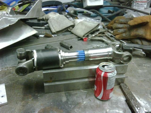

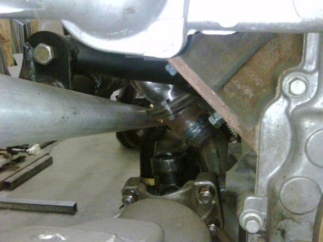

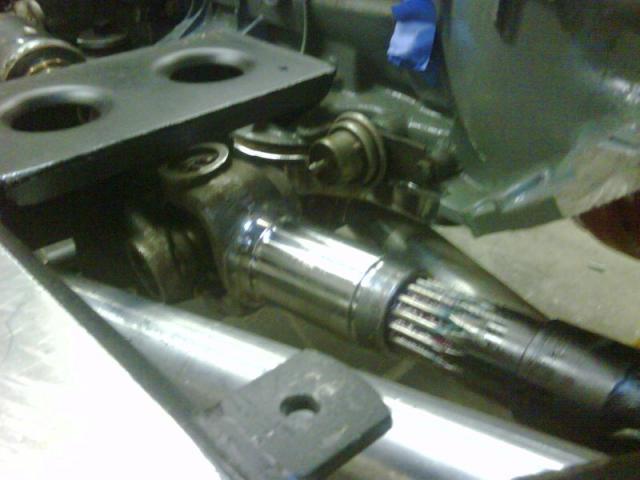

Machined some drive shaft parts and got things together for the front 2 piece shaft.
The female slip yoke was just on there for welding purposes....
Clark I'll post some pics of the complete front drive shaft steady bearing setup for you tomorrow.

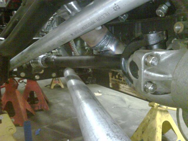

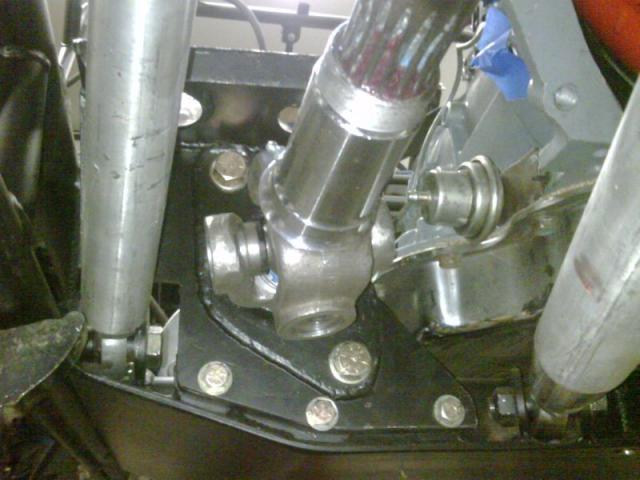

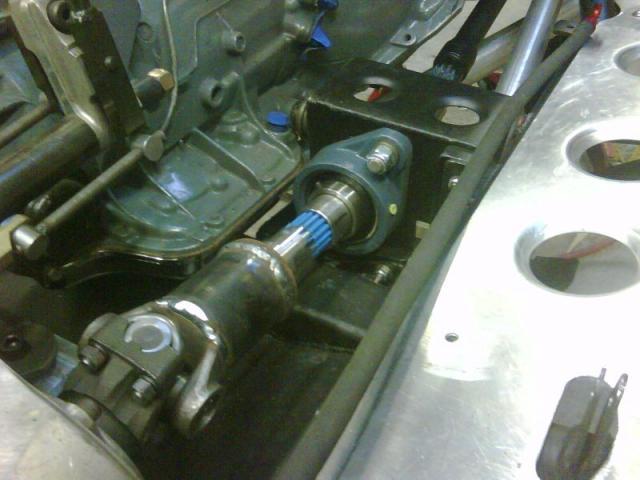

Front driveshaft. S&N Fab style. Machined D50 axleshaft, carefully welded to a male spline end. I went with this style of carrier bearing thinking if it did fall apart at speed it was still captured in the mount hopefully helping my passengers legs survive the breakage.

Looks really good Chris. :awesomework: More workie... less picture taking. :flipoff:
